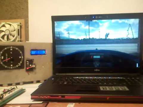

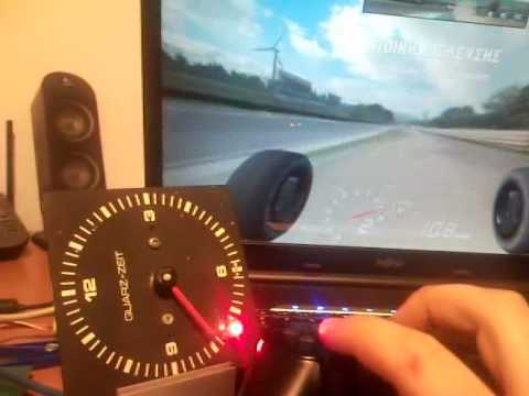

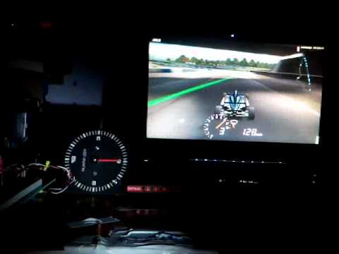

its working with the servo
but not with the stepper motor
the stepper motor code is already tested
I have to change a value only
position = map(time,56000,38000,40,0); //pulse meter
position = map(rpm,127,255,40,0); // rpm meter
i will find it
i finaly made it
i think that the problem was not only my code
but not on pins 12,11,10,9 that i have it from the begging
i will test the pins tomorow
now i am not going to post the code yet because i have also two servos and i want to use them as fuel and temp meter
