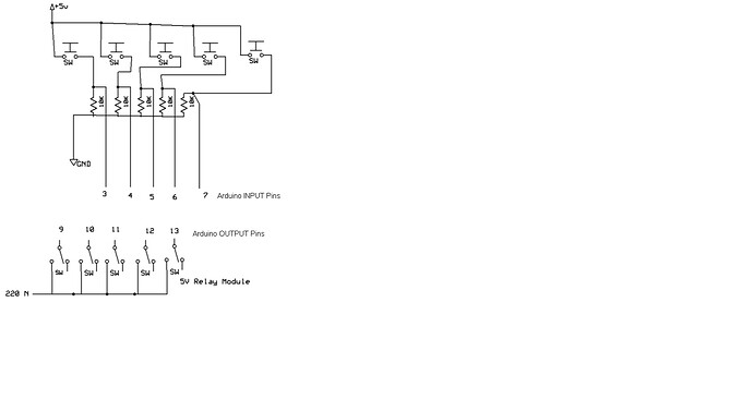

I am using Arduino Uno and 6 port relay module ( not opto isolated some local made) to operated solenoid valves.
Input method is push button attached with 10k Pull Down resistor to Grnd. Relay operated at +5V. It works perfectly with all push buttons and operate on timers assigned in Sketch to stop after some secs.
But I am encountering strange behavior with relays. Sometimes thy switch on (NC) itself without push button and have to stop manually with stop button. Is it the cause of Isolation or something else. We are using it 12 hrs non stop with approx 300 Start/Stop a day. It happens 10 to 15 times in 12hrs operation that all all or some relays switch on itself. Will opto Isolated relay module solve my problem ? Or something to do with Push button input apart of pull down resistor ??

Can you post a complete schematic (including a schematic of the relay module)?
Also - can you describe (or better, diagram) how you have things arranged in this control system - that is, where the relays are located relative to the Arduino, where the switches are located relative to everything else, how the wires/cables to the switches and from the relays to the solenoids are arranged, as well as perhaps the location of any other machinery (especially electrical in nature!) in relation to the system.
Without this, we'll simply be making guesses.

Heres my very rough schematic buttons connected to pin 3,4,5,6,7 of arduino,
http://postimg.org/image/4fo0ezbr1/
Your 1st post mentions no connection between +5V and the switches.
If this is the way you have things wired, no need to have pullups.
Try placing a .1uF capacitor across each resistor to filter out noise.

+5V --- Push Button -- (10K to Ground pullDown) and -- Arduino Input Pin. No Pullup. This is my current scenario. But still getting fake inputs at arduino pin. I applied input_pullup today. Let me observe what happen.
What is your application, what are you trying to do and what are you switching with the relays.

Sorry but we are up to #16 and still have no schematic, which you should have, if not draw one, the reverse engineering experience may help you locate your problem.
Simple setup. 4 Relays, 5 Push Buttons with 10K to Grnd (PullDown)
Each Push button operate sets of relay and 5th to stop all.
Relay operate at +5V (at High)
Sometimes it operates by itself without button press.
Unable to attach image tried with icon may be size issue. posting url
http://postimg.org/image/xfatqcv0f/
