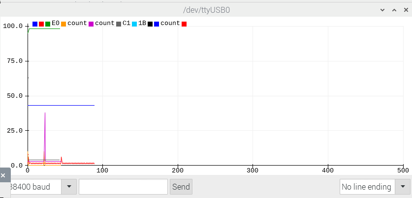

Whilst debugging an ESP8266 D1 Mini program, a strange (active) graph appeared. I am using the Arduino environment on a pi 400.
Has anyone seen this before? What is it and why has it appeared? The content has nothing to do with my program.
You launched the serial plotter program, rather than the serial monitor.
OMG! I've been using the IDE for a number of years and didn't even know of it's existence, let alone the Menu entry! Apologies for wasting folks time, and thanks for your rapid reply jremington.
