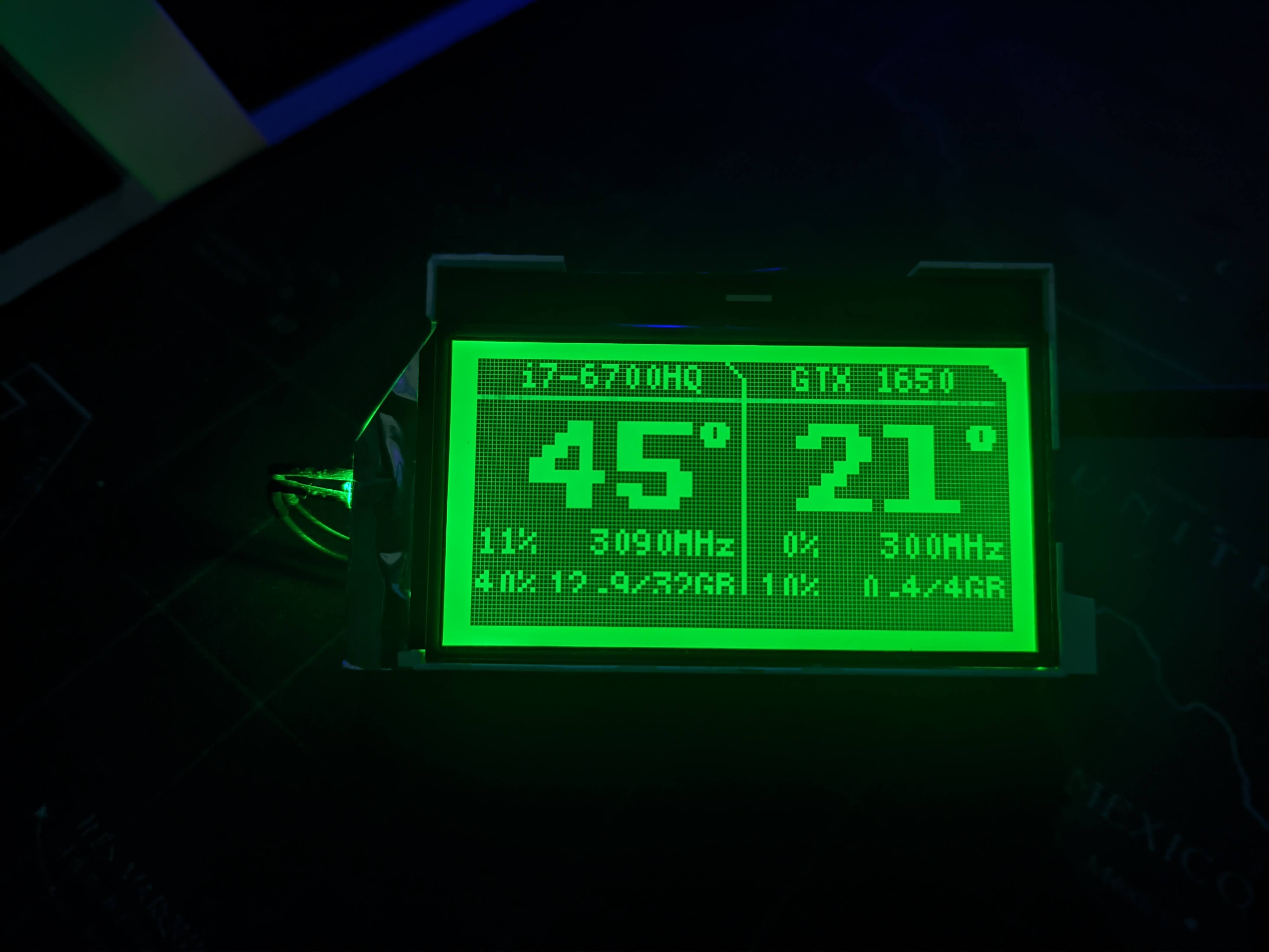

I'm working on a PC system monitor using an Arduino pro micro, an ST7565 display and U8g2 lib.
The code works kinda well, but I have a strange problem.

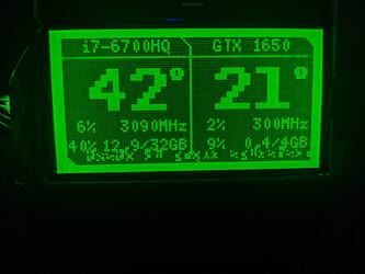

I setup a logo that appear when PC stop sending data, but with it set, I have a rectangle that cover the bottom part of the screen. If I delete it I have no issues. I tried to put a drawBox and I have the same problem. If I put a test in that part of the screen, it doesn't clear and stay above the new page.
I really can't understand why it happen only on the bottom part of the screen.
This is the screen as it should be, but I cannot set the actual splashscreen
This is the screen with splash applied (same results with a drawBox instead of drawXBMP)
And this is the screen if I set some text instead of a draw.
It seems that for some reason the screen doesn't clear property.
This is my actual code

  if (millis() - saveMillis > 30000) {
    disconnect = true;
    saveMillis = 0;
  //delay(10000);
  if (disconnect)
    u8g2.firstPage();
  do {
    u8g2.setDrawColor(0);
    u8g2.drawXBMP( 0, 0, nvidia_logo_width, nvidia_logo_height, nvidia_logo);
  } while ( u8g2.nextPage() );
    data();
I would suspect a memory issue, but the sketch does not appear to use a significant amount of ram (less than 30%). Does the problem get progressively worse over time? If so, get rid of the String variables and use char arrays.
Where did you find the pixeloid font? That is not a font that comes with U8g2.
No, it doesn't get worse than this
It's a custom font that I create with Fony
I somehow miss curly brackets and "else"...
Thanks for your answer! Now it works perfectly!
