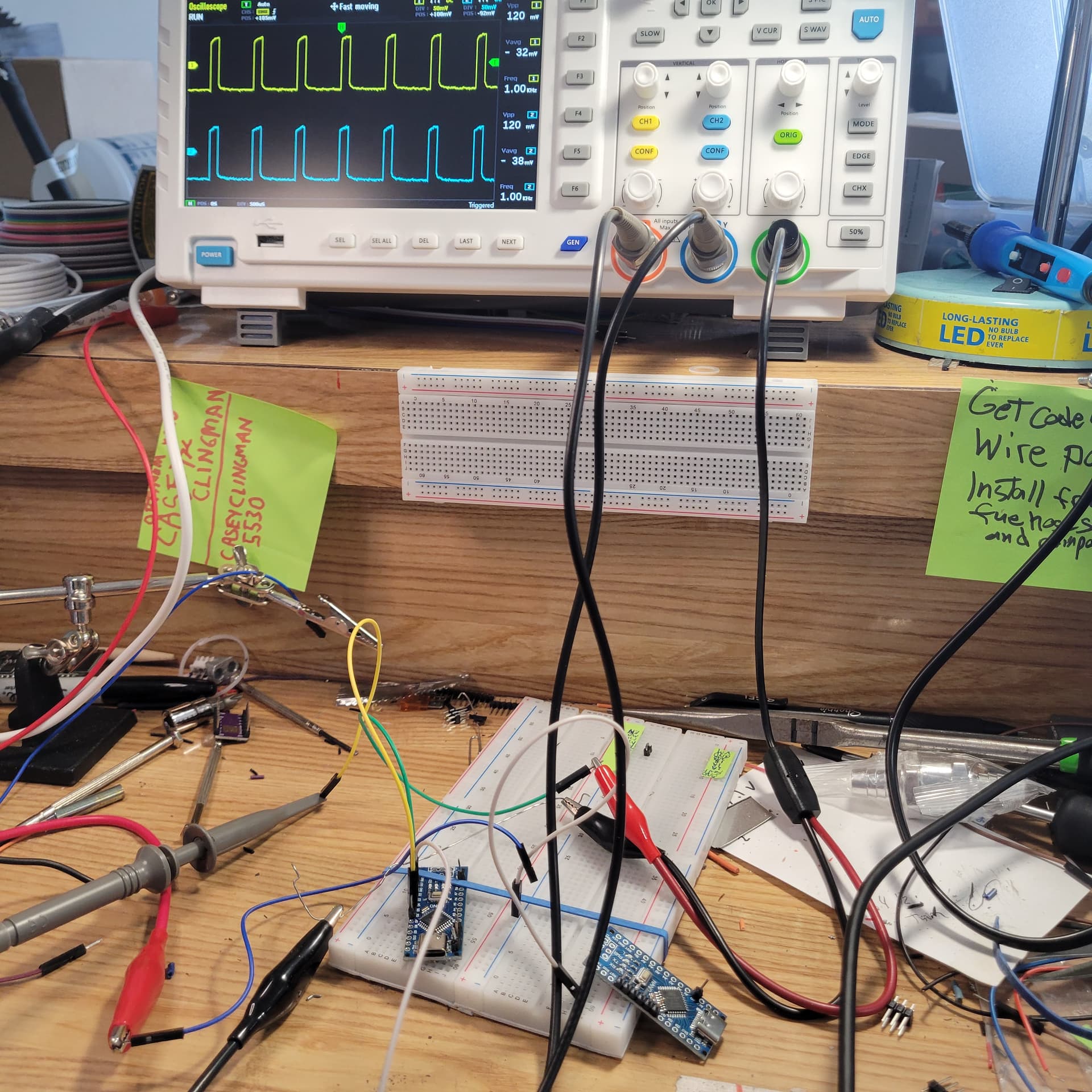

Noob here.
I programmed a Nano to produce two digital outputs from 2 inputs.
But my real issues started using my new $180 oscope/signal generator. (ADS1040D)
I was getting signals out of all digital pins.
One of my inputs was analog, and I removed it, and again, signals on all digital pins.
I removed power from the Nano, and still got pulses on all pins.
I tried an unprogrmmed Nano and it was very similar, though some values were different.
The only time the outputs stop, is when I remove the, single digital input.
It seems like I'm hooking up the oscope correctly; an output and an input, and using Auto Run.
Also removing the probes' grounds completely, does not stop the input and output waveforms.
I've double and triple checked for crossed leads etc.
I must be doing something very basic wrong
Can anyone help?
Are all your grounds connected to the same point? Each probe must have its ground connected.
To test whether the signal is EM pickup from the scope leads, short the scope probe tip to scope ground. Those long loopy connections with alligator clips are great antennas.
Scope probe artifacts are among the worst of beginner problems, and more are in store. Use 10X probes for most day-to-day work, and avoid long wires like the plague.

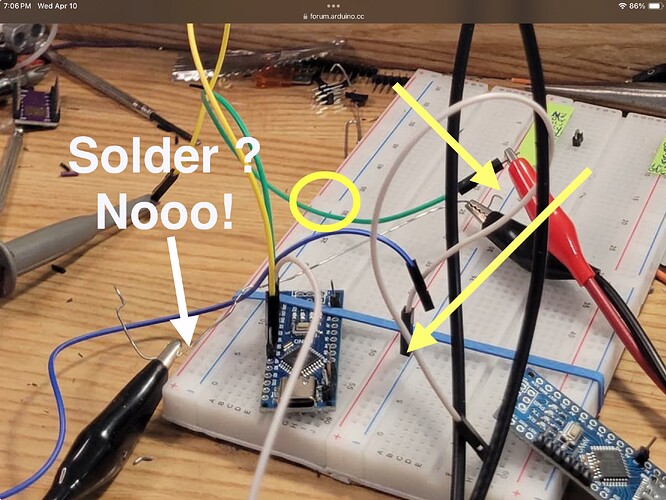

Looking at your picture, I see you are using LED lights. Turn them all off and any fluorescent lights.
I see only ONE possible scope probe. Did you adjust the compensating capacitor as per scope instructions? You are showing two traces on the scope, but only ONE possible 10X probe in the picture. Where is the second 10X probe?
With the power off your nano is a block with resistance between each of the pins. With no load you are getting what you should.
Also
  • Looks like your channels are set to AC coupling.
  • Suggest you use DC coupling for most controller situations.
  • Suggest you show us better all inclusive wiring connections.
  • Suggest you become a bit neater on you workbench. :pleading_face:

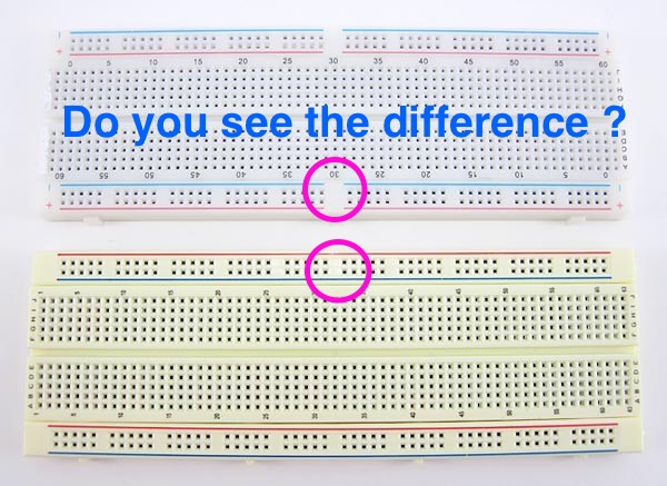

  • It appears there might be an issue with split power rails.
  • Make sure you understand the ramifications of breadboard split power rails.

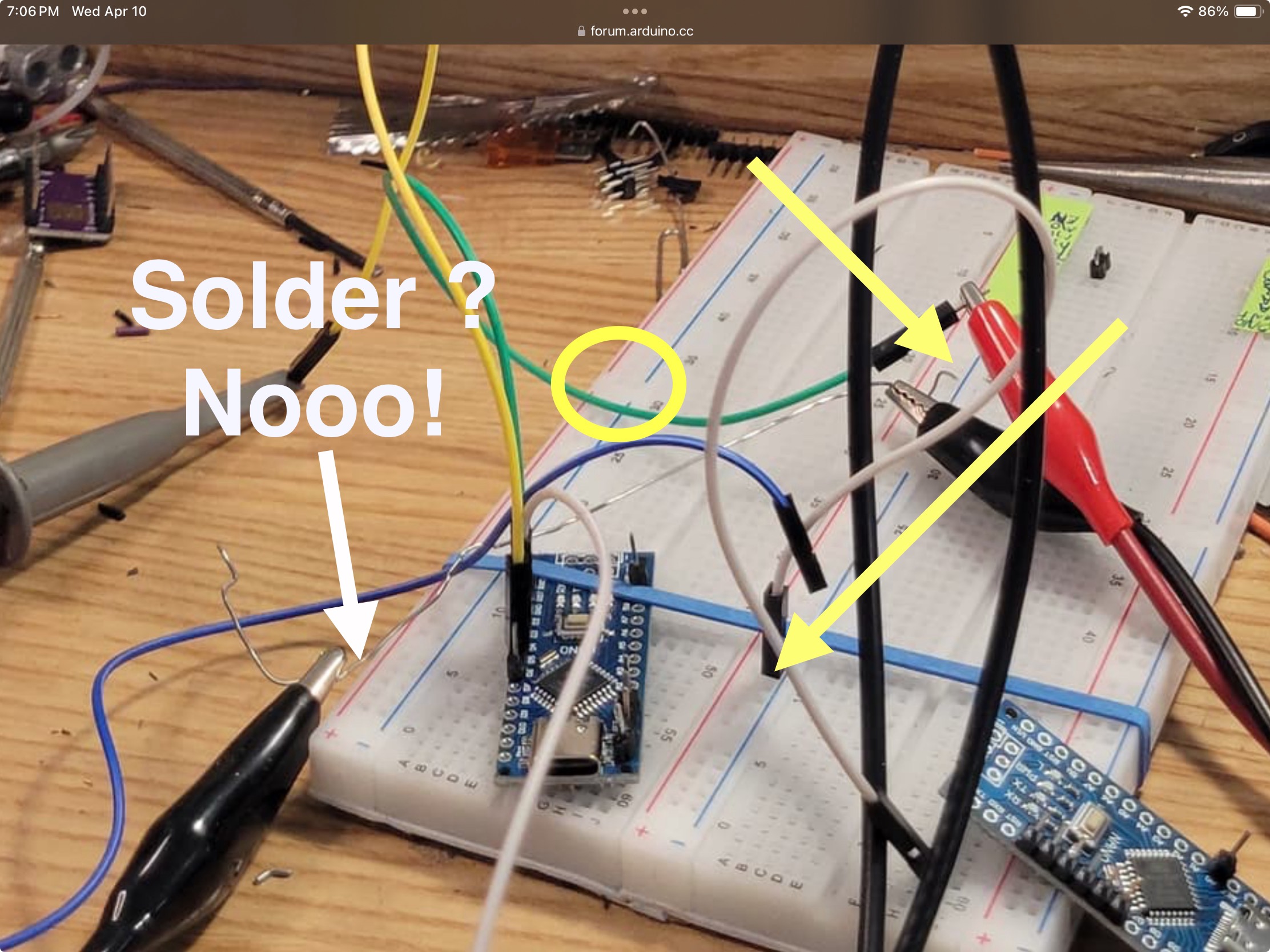

You busted me on the solder.
I'm going to use a proper gauge wire.
They WERE all on 'blue' with continuity to the nano gnd.

IMG_2735
No power on the Nano?
Where is the power supply connected to the Nano?
Wow, yes. Thanks I owe you one.
USB[quote="mikedb, post:16, topic:1246285, full:true"]
[/quote]
Off the laptop USB.
