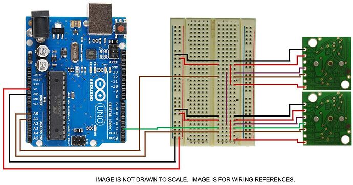

Strange output using 2 Ultrasonic Rangefinders
I'm trying to use 2 Maxbotix Ultrasonic Rangefinders (LV-EZ1 Maxbotix Ultrasonic Rangefinder - LV-EZ1 [LV-EZ1] : ID 172 : $28.50 : Adafruit Industries, Unique & fun DIY electronics and kits). I've done a decent amount of research on how to chain them and synchronize them to receive the desired output, but I'm getting strange values. Maxbotix has some excellent documentation. I'm following the guides from here: http://www.maxbotix.com/articles/085-pt5.htm#LV. I'm using the "Multiple Sensors Analog Voltage" method, with this layout:
and the following code:

When I run the code, I get the following output:
S1=441cm S2=268cm

NOTE I put my hand in front of the sensors at one point, those are the values where both sensors read ~17-21cm.
S2 is consistently low, and occasionally jumps all over the place. I've checked many times to make sure I'm connected to the correct pins, I'm not sure what else to try. Any help is greatly appreciated!
the Arduino only has one ADC and this ADC multiplexes the analog ports.
That means a measurement on one can affect the other.
sometimes ignoring one read might help
void read_sensor()
  //Used to read in the analog voltage output that is being sent by the XL-MaxSonar device.
  //Scale factor is (Vcc/1024) per centimeter. A 5V supply yields ~4.9mV/cm for standard range sensors
  anVolt1 = analogRead(anPin1);
  anVolt2 = analogRead(anPin2);
How are you preventing one sensor reading the echoes from the other?
AWOL:
I'm following the documentation here: http://www.maxbotix.com/articles/031.htm and using the exact guide here: http://www.maxbotix.com/articles/085-pt5.htm#LV for "Multiple Sensors Analog Voltage"
robtillaart:
void read_sensor()
I'm getting even stranger values doing this technique

just to test, can reverse them? (might give an indication of what's happening)
void read_sensor()
What happens if you read only one?
