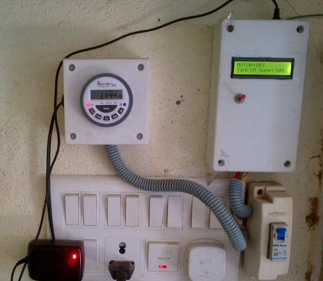

Hello Friends.....I am facing a strange problem.
I have two independent systems connected to the same power source (AC 220V). One is frontier digital timer 619 (http://www.king-ielec.com.tw/all/manuals/timer/619mode_619.pdf) for controlling my drip irrigation for the plants and other one controls the water level in the overhead tank, which is built on stand-alone Arduino atmega 8. Both systems are installed side by side as shown in the attached pic. Problem is when the timer switches off(not every time, but most of the times), it makes either the water level control system hang or reset. Not sure what is causing this issue. Timer is directly powered by AC 220V and Arduino stand-alone is power by 12 V SMPS adapter, which was regulated to 5V using 7805, tried replacing the adapter with new one, but no luck. If I disconnect the timer, water level control system works perfect without any issues. Any suggestions are welcome….
Drip controller (timer not so much as valves) is sucking too much power. When timer activates valve(s), it draws down the power so much that the arduino resets. To validate, power the arduino off a different branch circuit, or a battery, for a period of time and see if you experience more resets when the timer activates it's peripherals.
Solution(s); 1) remove some of the other loads from the service branch, 2) power one of the elements of this system off a different service branch. 3) put a bunch of really big electrolitic capacitors ('filter' caps) in the arduino's power circuit (between the 7805 and the SPS). 4) power the arduino (not it's peripherals) off a battery.

I also notice that the output of your timer runs directly under the wall wart. Could you perhaps reroute this. It's just possible that RF interference on this line is somehow causing problems to the logic of your power supply.
You could try an earthed shield around your controller as well. It does sound like either power or radio interference causing the problem.

Thanks all for your responses and sorry for my delayed response, it took some time for me to draw the schematic in Eagle as it was my first schematic. I am a kind of perf board guy and never used any CAD software before, but it was a good learning :slight_smile: . I have tested this circuit with another external power supply and the results are puzzling.
This circuit was built on ATMEGA8L-8PU and I have loaded Arduino boot loader on it. When I tried with another 12 V power supply (which was built on LM350 with 2AMP transformer) Arduino comes up as normal. When I power on and power of the drip timer, I have encounter the same problem Arduino hangs, this rules out the power supply adaptor as a culprit. Another problem noticed was, every time I switches off the power supply, something happens and Arduino won’t come up, this power supply has a 4700uf/50V capacitor inside and voltage decreases gradually when it was powered off, not sure gradually decreasing voltage is causing some issue here. I had to reload the code to make it functional. This pointed out me to doubt ATMEGA8L and boot loader. So I have replaced the ATMEGA8L with boot loaded ATMEGA328 and everything works perfect and I could not recreate this problem, monitoring it since last 24 hours and everything looks good as of now. This opens up new questions, why this problem is only with ATMEGA8? Is it boot loader problem or something else? BTW, I tried with two different ATMEGA8 chips, encountered same problem and ATMEGA328 works fine.

Tom, The distance between arduino and float switches is around 40 feet. Yes, these wires are running in same casing of power wires. I too suspected the noise and tried .1 uf across the float switches, but that did not help. I have also grounded the arduino properly to the earth. pull down resistors are 10K. By the way, this problem is not repeated since last 5 days after I replaced Atmega 8 with Atmega328. So I am puzzled why this problem is only with Atmega 8.
