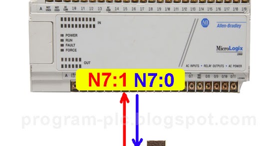

Hey guys,
This is hard to explain but here goes!
I'm using this DF1 library Here to communicate between a Micrologix 1200 plc and a Mega. I also have 2 Mega's communicating with a Max485 and this is where the strange behavior happens.
I'm using the default serial port for the DF1 and then I'm using Serial2 for the Max485 communication between the two Mega's. In my code below you will see I have my Serial2.begin(9600) but this sketch will not work unless I begin Serial3. ?????
I have nothing hooked up to 3 and do not need it anywhere in the project, so why does this only work with Serial3.begin(9600) added to the sketch.
I have even tried modifying the code and wiring up to Serial1, but I had to begin Serial2 for that to work as well. Seems like I always have to .begin the next port in line to work.
I'm clueless here!!! Any hints would be awesome!

Unsure but, on the Mega there is no Serial, Serial0 thru Serial3. Your line
DF1_configure(&Serial, DF1baud, DF1format, DF1timeout, DF1packets, DF1TOTAL_NO_OF_PACKETS);
is trying to pass the address of Serial, which doesn't exist, and perhaps it's defaulting to the last serial port, Serial3.
As a side note. you know that DF1writeRegs[] has fifteen entries so instead of zeroing all in setup, change your declaration to
unsigned int DF1writeRegs[15] = {};
and they'll all be zeroed for you.
Just as another aside, we can copy your code into an editor and look at it, only. If you use a non-standard library (DF1) it helps to attach it so at least we can try to compile your code.
DKWatson:
The correct part of that statement is "on the Mega there is no Serial0".
Serial: 0 (RX) and 1 (TX); Serial 1: 19 (RX) and 18 (TX); Serial 2: 17 (RX) and 16 (TX); Serial 3: 15 (RX) and 14 (TX).
Whandall:
I was under the impression that Serial0 and Serial are the same thing?
...R
If you try to use it you get (on my clone Mega)
Whatever:24: error: 'Serial0' was not declared in this scope
Serial0.begin(250000);
I stand corrected. I guess that means my solution won't work either?

Robin,
Sure here is the blog where I found the library. He only had a video demo and posted some sample I/O code.
You have to jump through a few loops and whatnot to finally get to the downloads part of the blog so I figured I would save everyone the hassle.
Here is where I found the library, not much instruction with it but I was able to get it to work fine with the Micrologix 1200. Other than this "begin" mystery.
