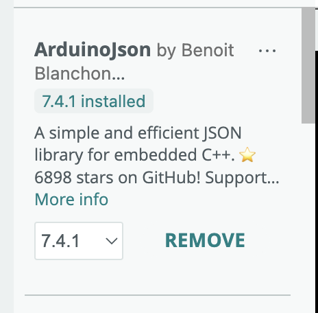

I installed the library in my IDE
And here is a list of the sample code with the library, I think that should give you a good leg up
Good luck
