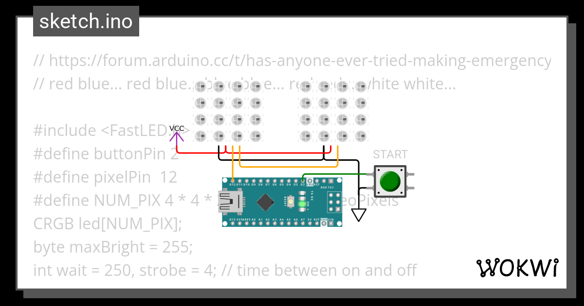

also here's a circuit image
by the way, this uses 8 pixels, as shown.

It was easier to run this than to read it to see what it does.
// wokwi.com/projects/419543065589286913
