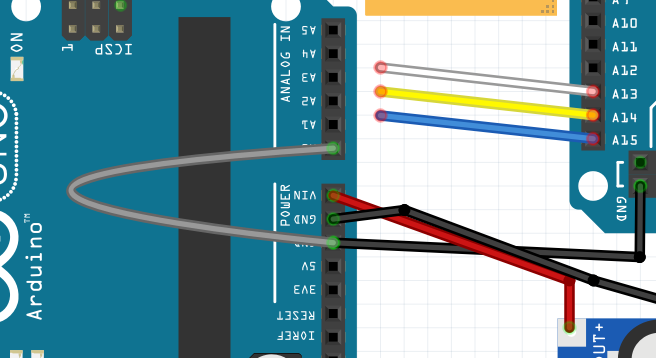

Struggling to get my UNO and MEGA to talk to each other properly (digitalWrite(LOW))
Hi. I'm going to post unabriged code and wiring diagrams at the bottom of the post, I've had to take apart my UNO and start putting it back together one pin at a time to claw back functionality, so I might post a scaled back diagram and abriged code to explain where I think the problem is, but the full story will be at the bottom of this post.

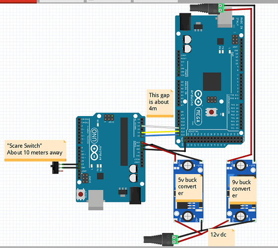

I have a setup to control an escape room, there's probably a million better ways to do this, but I'm amateur so I'd appreciate the help. My setup is made of three parts;
  • An arduino MEGA, controlling most aspects of the room. Lights, doors, relays etc.
  • An UNO, specifically for scares, lights and horror sounds
  • A couple of esps, controlling keypads, LCDs and an ultrasound distance sensor.
The uno and mega are connected to a "scare switch" about 10m down the corridor that basically blocks anything spooky in case my customers don't want to be scared. Currently both boards are reacting properly to this switch (for once, haha).
The esps are communicating properly with the mega when I send the following low 600ms 'pulse'

But then I send a similar low signal from the mega to the uno;
  if(circsqtriSwitch.fell())
    Serial.println("1612 complete");
    digitalWrite(circsqtriSig, LOW); // Tell the scare uno that 1612 has been input
    firstcams();
This signal doesn't get picked up by the uno (here's the code that's looking out for it);
  circsqtriSwitch.update();
    violentAttack();
Here's an abriged diagram of how it looks
I'm thinking it has something to do with ground reference, like, the mega pin (pin A15 is already at ground, therefore digitalWrite(LOW) doesn't cause the pin to "fall" and trigger the violentAttack()
As per the diagram I've connected the grounds together (they're actually connected via the scare switch ground pin but I guess it's all the same).
It works when I disconnect the cable from the UNO pin A0, then short the pin to ground. Doing this triggers violentAttack() (the same is true for pin A1 and A3) a la this diagram;
ground short
Interestingly, this doesn't work when the pin is connected to the mega (I.e. UNO A0 connected to MEGA A15) which is why I think the pin isn't "falling" when the puzzle is completed and the pulse is sent, it only works if the pin is disconnected.
I initially solved it by writing the 3 mega pins high in setup, then they worked. The problem is it caused some funny business with the UNO, in particular when I disconnected Vin and gnd from the UNO, it was still powered through these pins that were getting this high signal. I'm not an expert but I'd imagine powering the UNO through the logic pins was a bad idea, so I turned this part of the code off.

So this is why I've come to the forum. I'd imagine there's a million ways to do this better, I'm currently looking into learning espNOW to controll all the microcontrollers wirelessly but for now I kinda need to get the experience reopened so if anyone had an easy fix for now, then suggested I look into a better implementation (i've heard of something called UART?) then I'm all ears.
Is there a way to write the three pins (A0, 1 and 3) as "floating", neither HIGH or LOW?
Should I use the non- analog pins? (actually, my spidey sense is telling me this might be the problem, I'll try changing the pins, and update today)

int circsqtriSig = A15; // UNO pin A0
int doorSig = A14;      // UNO pin A1
int reedSig = A13;      // UNO pin A3

// Pins for scare switch
int scareSwitch = A9;
int switchState;

  pinMode (circsqtriSig, OUTPUT);
  // digitalWrite (circsqtriSig, HIGH);
  pinMode (reedSig, OUTPUT);
  // digitalWrite (reedSig, HIGH);
  pinMode (doorSig, OUTPUT);
  // digitalWrite (doorSig, HIGH);
    firstcams();
  if(rfidSwitch.fell())
    Serial.println("rfid complete");
    digitalWrite (doorSig, LOW); // Tell the scare uno that the door has been opened
    dooropen();
  if(reedSwitch.fell())
    Serial.println("reed complete");
    digitalWrite(reedSig, LOW); // Tell scare uno that the magnet is in the recepticle
    firstobjective();

Mega diagram

The best thing These fritzy pictures can do is look fancy.
Fritzy pictures are bad about being focused on the real important information.
You shold hand-draw schematics that show that IO-pins that are relevant.
As you are using so looong wires there might be a problem with ground-loops
best regards Stefan
Thanks for the help, I'll look into what you've said, but, the first line of my post said "I've posted unabriged code and schematics at bottom of the post" OWTTE.
The full code was provided in the post (unless I'm misunderstanding your response)
Put a diode in-line between the Mega and UNO, so that the Mega output can only pull the UNO pin LOW. The HIGH level is then provided by the internal pullup on the UNO, and you will not get phantom powering from the Mega. Of course, if you never have the Mega output set to HIGH, there cannot be a transition from HIGH to LOW.
Why are you running software serial on a Mega, when you have three unused hardware serial ports?
Good idea thank you, I'll do that and report back, it has worked for me at other times in the past not having the pin go "high to low" but go "inactive to low" and still work, but I'll try the diodes.
I've reused and adapted the code from an uno running an mp3 player and an I2C LCD screen simultaneously, I just haven't bothered removing it

I think this picture answers your question but I'm not sure I might be misunderstanding
where is the power connections to the Mega?
i see connections to Gnd, A9, A13, A14 and A15
also, Vin to an Arduino needs to be >= 8V
5V can be supplied directly to the 5V connection
The jack at the top of the mega is connected to the 9v
I had no idea the Vin needed > 8v, I thought it was 5v! I think I confused my ESP Vin voltage which is 5v, thank you for pointing this out, I shall make the change.
see Feeding power to Arduino:
