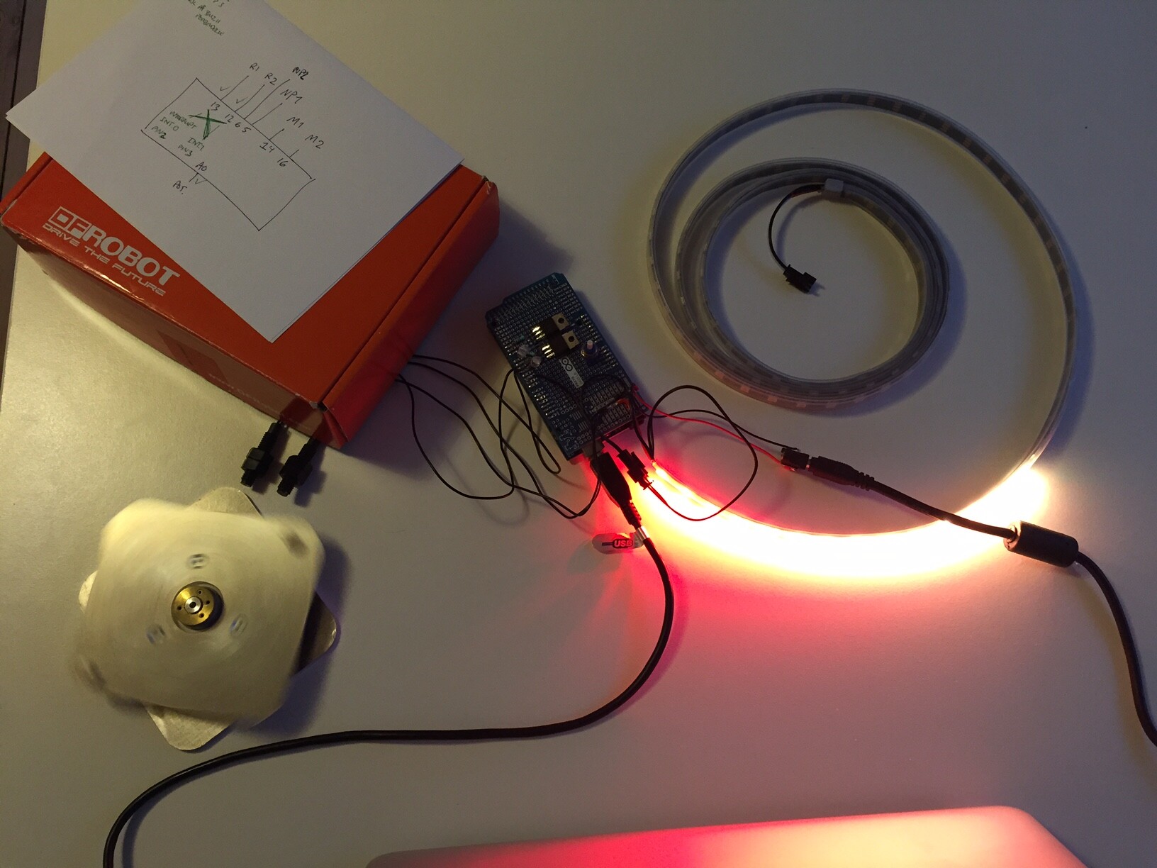

My program is supposed to calculate a RPM from a reed contact counting "ticks" and display the result "realtime" on a neopixel 120 pixels. (im going to control 2 indiviual neopixels when this is working)
My problem is that the program stops working and freezes after some seconds. It works okay until it freezes. I guess that something is overflowing but i have no idea what.
Any help appreciated - im not a programmer by heart and this is a mix of several code snippets found on the net and my own.

if (millis() - lastmillis == 1000){ /Update every one second, this will be equal to reading frecuency (Hz)./
Change to:
if (millis() - lastmillis >= 1000UL)
Solved!! Thanks a lot
