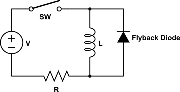

The 2N2222 transistor base resistor should be more like 180 to 220 Ohm's and like wildbill says, you need an external power source for the motor. Also there should be a flyback diode across the motor to protect the transistor from back EMF.

@groundfungus . Check on Flyback diode. Will hook up as pictured here, although I don't really get how that could work. I'll just take your word for it (for now). Luckily I have a few 1N4007s in my little kit.

Diode NOT optional.

Diode NOT optional.
Hi groundFungus,
Thanks for the diagram. I understand now Faraday's Law and the purpose of the flyback diode... but why the capacitor?
The cap can prevent high frequency noise from arcing brushes from getting on the motor power supply.
