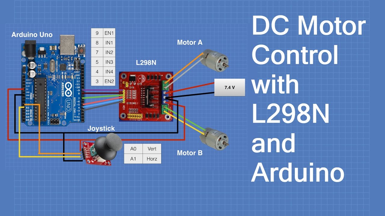

am a newbie, wanted to do a project which involves two P12-P linear actuator (two Max. Operating Voltages: 6V or 12V), a thumb joystick and a arduino (am not sure which one to buy)
So basically, i want to control actuators using joystick.
When joystick is moved left, one actuator should extended upto to certain length
and when that joystick was centered, same actuator should come to retracting position
When joystick is moved right, another actuator should extended upto to certain length
When joystick is moved up, both actuator should extend up to certain length and should stay there even though joystick was centered.
When joystick is moved down, both actuator should come to retracting position and should stay there even though joystick was centered.
I wanted to use either Auxiliary car power outlet (12 V DC) or any other rechargeable battery pack as Power source, so need your input on which arduino should I purchase that i can work with above mentioned actuators, which version actuators(6V or 12V) and what battery pack? and if any other components if required.
if possible, diagram of connections and arduino code will be helpful.

Yes you can power with 12v through the barrel jack if the Arduino and what is connected to it are not using too much current. Heat gets dissipated through the voltage regulator and 9v is probably preferred.
Your two actuators can not be driven directly from the Arduino, and I recommend a dual channel motor driver based on the TB 6612 like this one
or this
Means it's better to use 7volt than 12volt on the DC socket.
An Uno runs on 5volt. Anything more than 7volt is turned into heat.
At 12volt, you can't draw more than 100mA from an Uno before the 5volt regulator overheats.
A separate 5volt cellphone charger connected to the USB socket is even better.
Leo..

What about current?
As per those actuator spec. It says:
Stall current: 550 mA @6v, 210 mA @12v
I think a got a very good reference from below video:
Thank you Delta_G, Romonaga, cattledog, Wawa. I started coding and making things working.
