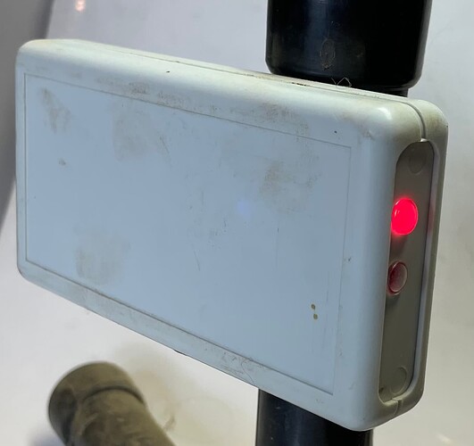

I'm making an IR beam break timer to train my dogs in agility.
The device that sets up the WiFi network is shown above. Internal components are a ESP8266 D1 mini and a 4 digit, 7-segment display
and a WiFi beam break detector sends a UDP message to the controller/display when the IF beam is broken and restored. The controller/display and the beam break sector use the same ESP8266 D1 mini.
I noticed that some reprogrammable wristwatches used these same components I was using (including an SH11106 display controller and D1 mini and wearable version
Now I'd like to reprogram a watch to have the same functionality as my mockup so I'm looking for suggestions about which watch to convert.
I don't need any functionality that comes with the watch. I only need to support becoming a WiFi controller. It must support Arduino create/Editor. I only need a single button to support reset and an off/on button
I would like to know people's experience in reprogramming wrist watches
