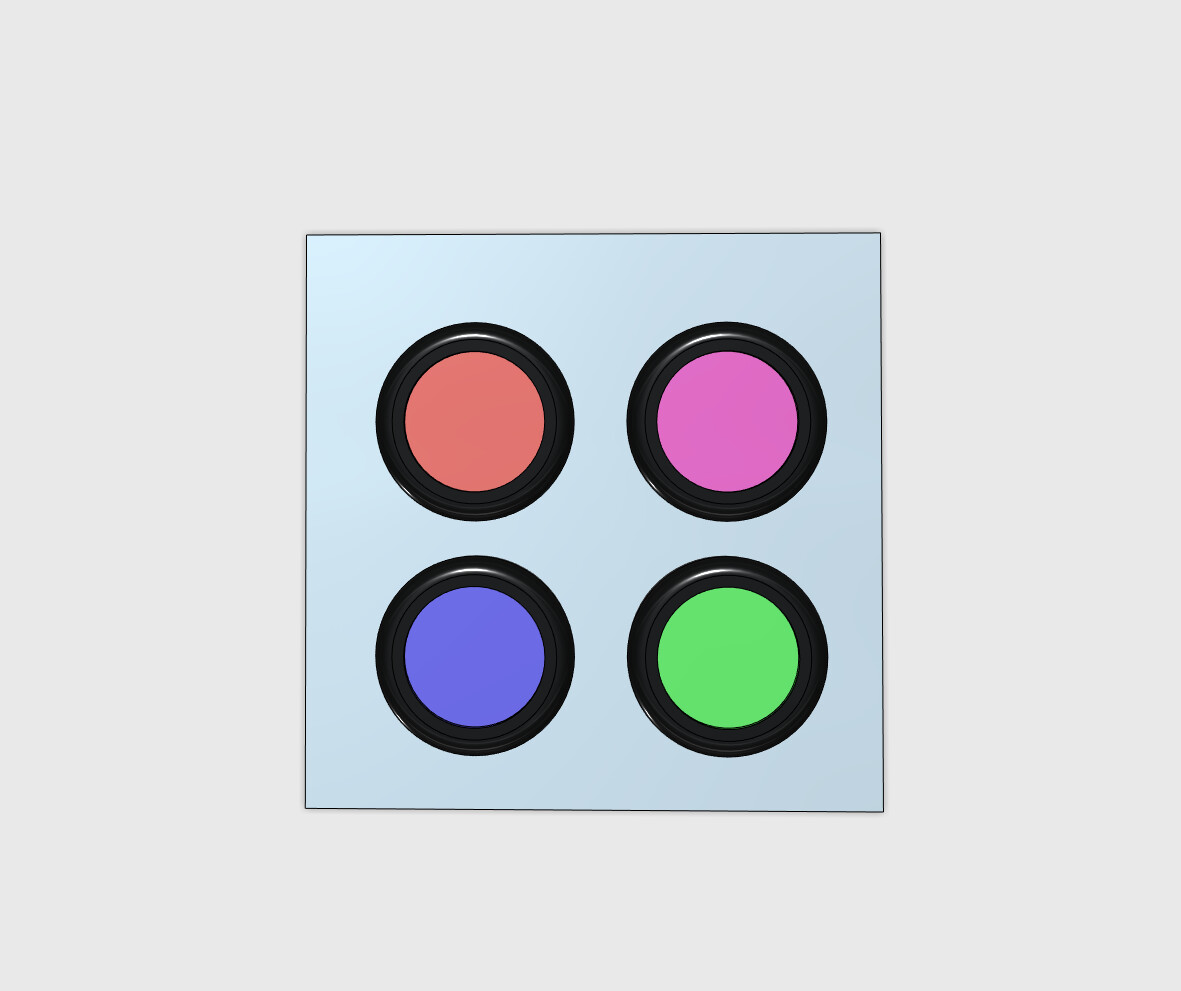

I keep going around in my head which one i want to pursue! I think i like the independent pixel idea, if i can make them cheaper. So while i was putting that decision off i took a moment to mock out a design for the actual led modules i intended to build, and discovered a problem that might make me abandon the encoder (or at least prevent continuous rotation):
Here is a face-on view that a user would see. As you rotate the black part, the bit in the center changes color. Should be pretty straight forward:

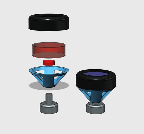

and here is a side view of the components of the LED modules:
From top to bottom, the components are:
-Outer hub (the part you grab and turn)
-LED Diffuser (make a nice consistent light)
-LED/Neo Pixel
-Inner hub (grabs and turns the sensor)
-Sensor
So you can see from this, the LED is in the middle of hte module, so the wires to control it go up through those holes. As the module is rotated, it will begin tangle up the wires, and if there is no endstop it will eventually rip them out.
The only other approach would I can think of would be to move the sensor to the side and have a belt or gear drive the rotation of the sensor, but i am not sure the complexity is worth it.

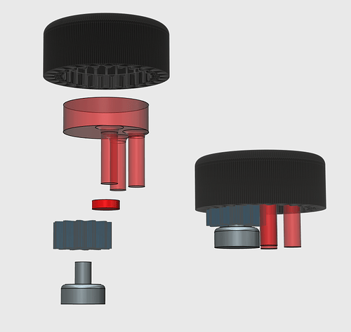

Actually i was being a fool, I think just making the encoder offset and turned by gear is the way to go. Designing and printing gears is a pain but this will allow the continuous rotation, and and the gear ratios will make it so the outer knob gets more states per revolution (i am aiming for a fairly subtle smooth transition.)
No, you still have it wrong! The last thing you want is to construct mechanical gears.
You need to understand the concept of a "light pipe". I note your proposed gear design is based on them, but not in a very practical way.
Again, I point out that NeoPixels are going to be the easiest way to implement this. Just make your "inner hub" transparent (translucent), and surround it with (at least) four NeoPixels pointing into its conical side. From eBay, four of these will cost you less than a dollar (should be much less). Note, you are not using separate coloured LEDs, each NeoPixel contains all three colours and you simply program them (in a chain) to show the same colours. (And they are bright!)

Well if anyone is curious, i got my new printer and some parts to play with, and got a working prototype pixel:Prototype light bright pixel
It ended up being a more complex mechanism than i orignially sketched out, but the fundamentals are still the same. I used a attiny/encoder/neopixle approach, which i think is around $1.40 a pixel if i get it all in bulk, plus plastic (which might double the cost).
