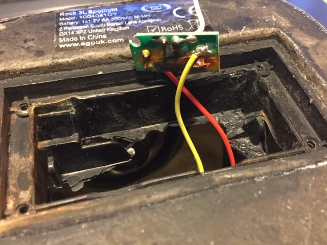

I have 3 out of 4 sunpowered spotlights that are not working anymore.
Usually this is due to the corrosion as you can see in the pics although these spotlights are sold for exteriour use.
I am trying to understand the schematics to reproduce it with a breadboard and then use it in a larger project with Arduino:
The red and yellow wires are the positive and negative poles of the solar pannel.
The white wire is the negative pole attached to the battery.
The positive wire of the battery that is now detached was soldered to the pcb where you can see a circle with a + and it was in series with a latching pushbutton.
The LED wires were attached to S+ and S- in the pcb (maybe)
The resistor should be connected in series with the power and the anode of the LED.
Before drawing an attempt of sckematics, what I am missing is how the LED become powered when it is dark. It is like when the sun pannels are not providing any voltage, then the rechargable battery are powering the LED. It is like the flow of current change path if a voltage is provided or not.
Or am I missing a component?
Thanks

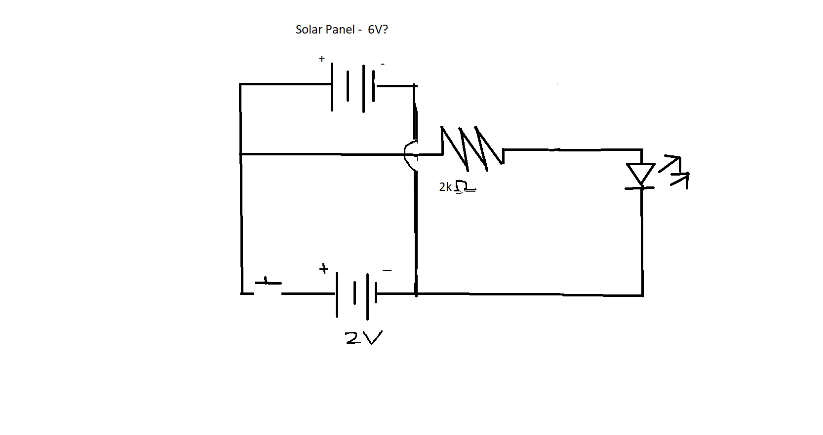

I have attempted this schematics below.
I imagined that the solar panel should have a voltage higher than the battery when it is lit by the sun.
Therfore, there are 2 circuits in parallel; one with resistance 2komh connect to the LED and one with low/nill resistance.
When the voltage of the solar panel is higher than the battery voltage, the current is flowing to the battery only due to the low resistance offer by the circuit while no enough current is flowing to the LED keeping it off.
When the voltage of the solar panel is either lower than the battery or zero, the solar panel can be assimilated to a high resistor or a break in the circuit (?) and the current flows to the LED.
But my attempt seems wrong since with no battery I should have the LED lit during the day
Any ideas?
thanks
How much current will your LED draw from a 2 volt battery when it has to go through a 2k Ohm resistor?

Yes, nothing. But I am not sure why that resistor is there. Maybe I cannot see well the colours on the photo but it seems a 1k or 2k resistor.
The fact I am not sure what is the working principle of this spotlight.
How can it turn on when it is dark?
The blue green component is an inductor, not a resistor. The circuit is actually a step up voltage converter, as described here, with an IC under a black blob.
More about that chip here.
