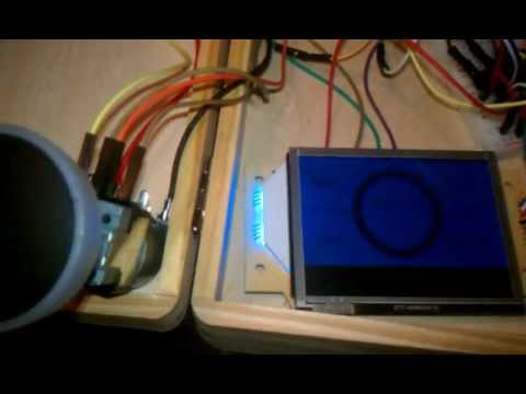

i'm well into my first ambitious project (I'm new to programing)
I'm building a controller for my boat. it'll handle ipod control, hydrofoil angle, ballast pumps and a few other goodies. The issue i'm having is finding a decent sunlight readable (transflective or reflective) screen that has decent resolution. I'd like a largish display that would be touchscreen friendly (either built in or compatible with the resistive nintendo ds touchscreen -- 2.2 x 2.75")
of course, i can't get anything too advanced since i'm a very rookie programmer, but i would like to have something with a bit higher resolution then what i have now:
i've tried a few others. one had a poor image in a well lit room (washed out) and poor viewing angle:
and the other was a nicer oled screen. but the resolution and screen size was WAY to small.
here is what i have so far in v1.0:
as you may be able to see, refresh rate isn't THAT important to me as i wont have a lot of animating graphics.

thanks again for the suggestion. but I'm trying to stay away from a complicated system (i.e. a computer) My previous version of this project uses a motion computing cl900 tablet running win7. the monitor is viewable in most outdoor situations except for direct sunlight. The interface is awesome and looks great. but it's not as reliable, simple or as instant (i.e. boot time) as the arduino based setup. I appreciate all your input, but i want to try to keep on point of the original question. which is to find a screen that will fit this project. The screen i'm working with now will work... but the resolution is just disappointing/limiting
