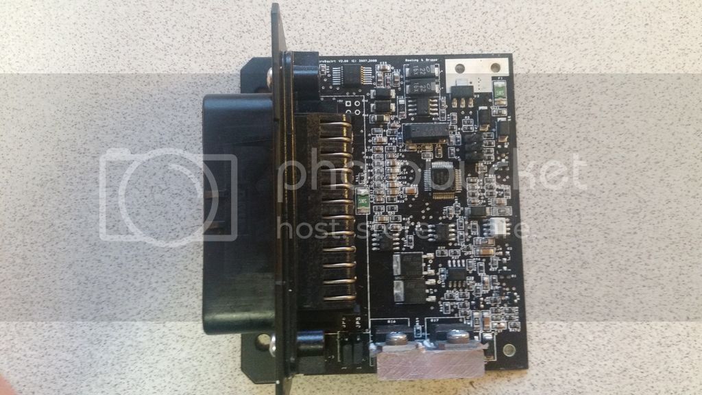

The ECU is a microsquirt v2 of dubious authenticity. The power supply is on the ECU’s PCB. Here’s a pic (not mine) of what I’m pretty sure I am working with, minus the AMP connector:
As far as cables connected to the ECU, there are sensors (engine and air temp, barometer, throttle position pot, exhaust o2 sensor, crank trigger) and control lines (fuel pump relay, ignition, o2 sensor relay, injector, and check engine light) as well as the mandatory +12v and ground. The wires are quite close to other wires that source and sink current.
