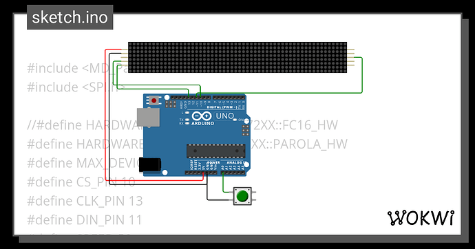

I have just finished this project and thought I would share it. I thought it maybe quite useful. If anyone can see anyway enhance this project or improve the sketch please let me know. Also after the display scrolls I would like it to stop for a few seconds, how would I do that?

what is the difference to parola example sketch? or to internet tutorials?
See if this code meets your needs:
