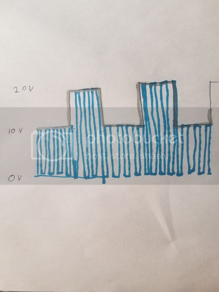

I would like to switch a mosfet at 10khz (not that crazy of a thing to do from my understanding) then have it recreate a second square wave over top if that makes sense.
so lets say the square second wave is 4hz (probably would be faster but for simplicity's sake) so we would have the initial square wave switch from 0-20 at 10kHz for 250mS then switch from 0-10 at 10kHz for 250mS and so on
Hopefully I did an okay job explaining this. Is this feasible to do with one mosfet or would I need 2, one switching at the 4hz frequency then one switching at the 10khz frequency?
Is this where Dutycycle begins to play a roll to get a simulated voltage like this?
better yet would be if i could accomplish the same task except setting current instead of voltage. So fluctuate between 20amp and 10 amp in a 4hz 50% duty cycle square wave over top the 10 khz wave.

Imagine it's all symmetrical and drawn to scale and at proper frequencies: The blue waveform switches at 10khz the silver is the 4hz waveform
Ok, thanks. That does make it much clearer.
Paul
Such a signal can be created from two digital outputs and a resistor network (2 bit DAC). Question is the nature of the load, that determines the amplifier circuit between the signal source and load.

Why is that? This is the standard for modern Inverter welders. They use an IGBT Module before the transformer switching at very high speeds (such as 10KHZ) this is why they are so small. Obviously there are many more electronics involved, but i am more looking for a proof of concept right now. If I'm not mistaken after delving more into the topic i should be able to limit the current with pulse width? and the voltage with Duty Cycle?
Right now I will Have a High Current rectifier, some Large Capacitors and probably 2 inductors to smooth the ac out, to a nice pure DC Wave, then using the arduino, a driver and probably a few other things i will output a varying waveform across the transformer, as long as it is switching fast enough there should be almost zero noticeable difference to the welder. Then if i can create a simulated slower wave form I can have pulse tig, mig, and even stick (not popular in the US yet)

You should limit the current with current-limiting feedback. Duty cycle, pulse width and frequency are linked together. You can't change one without changing one (or both) of the others. Most of the time we use constant frequency and we change duty cycle. Pulse width does change but we don't care what that width is. We just look at the % duty cycle to work out how much power is going to the output.
