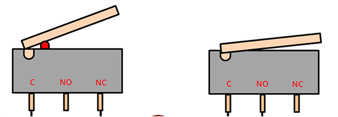

Below is some sample code that I found in the forum that was originally written to monitor one button which I've modified to monitor 10 switches. Normal game play creates a lot of "false" status changes when reading switch statuses. My question is this... is there a better approach or Library (e.g. ezButton) that would simplify this code?
I am using a Mega Arduino with most of the pins being used for other items not shown here.
In my arcade game application, I have 10 targets that rest against individual switches that are in the "closed" position when the target has NOT been knocked down. When the status of the switch is read, LOW returns when the target is still standing (normal state) and HIGH returns when the target has been knocked over. During normal play, vibrations give "false" readings and tell the circuit the target has been knocked down when in fact the target may have teetered but not fallen. I'm going to need to essentially debounce the input pullup at the first potential status change to filter out the noise and again at the end for typical switch debouncing needs.

> [@deronbutler](#):
> ```arduino
> const int switchPin[] = {23, 24, 25, 26, 27, 28, 29, 30, 31}; // the number of the pushswitch pin
You say you have ten targets. I count only nine pin numbers in this array.

There's a lot of off-by-one errors, confusion between `reading[i]` and `reading`.
Fix those, and move the state and time updating bits into the place where you detect the change.

No, I don't think so. I would not use a library in this circumstance as you may find it beneficial completely own the problem, so you can tinker and adjust it with full knowledge of what you are trying to do.
Arrays in C++ begin at zero, so your 10 switches should be 0 to 9 as indices into your arrays.
You only have nine pins in the pin array or I am being blinded by the sun here.
Parallel arrays work well, you might take a moment to look into structured variables, the _struct_ concept in C++ allows combining variables of different types to be packaged so they travel around together.
But parallel arrays work fine, and can leave less visual clutter around. The big step you have taken is using arrays, use them whenever you can:

ok i believe i've made the initial corrections needed. I made these changes to the sketch:
- corrected pin array to include 10 (was 9)
- for loops now 0 to \< 10
- added [] to "reading" variable where missing
- used array for pinMode setup
@alto777 I'm not sure what you mean by "a7"

At present, my wiring circuit looks like the switch shown on the right on the image below.
 ![image](https://europe1.discourse-cdn.com/arduino/original/4X/d/2/a/d2a647a3a8fb606f6b18b404515bb6010b291d3b.png)
The arcade target sits on the micro switch and keeps it in the closed position. When the arcade target gets knocked down, the switch looks like the one on the left (ignore the wiring on the left image). However, I have the wire to the NO pin like what is shown on the right image. With this setup, the micro switches of my arcade game are "LOW" when the targets are in the upright position and "HIGH" when knocked down. Is this conventional? If not, I can easily switch the wiring to the NC switch so the targets are "HIGH" when upright and "LOW" when knocked down. Could you please let me know so I can get that wired more conventionally then I'll try the code again with the various above suggestions.

> [@deronbutler](#):
That looks most odd. What is the diode for and where is the Arduino input?
I can't see how that would work.

@DaveX RE: Post #8
I see this post is coming in after some new posts after my post #12 so I did not try any of those suggestions. This post specifically addresses the proposed solution of Post #8 which seems to work. Here is the post I was working on....
I elected NOT to make any changes to the switch wiring (left it as normally open) and then tried the code in your post #8. I tweaked that code a bit more as follows:

@Grumpy_Mike
you busted me again for an incorrect/misleading image. I should have displayed this:
 ![image](https://europe1.discourse-cdn.com/arduino/original/4X/4/7/e/47e9bf692d4c4507fc9a4b46ec2c5ca85d2096b0.png)
I intended to show the switch arm in relation to the micro switch AND to show the switch was being wired as NO. There is no diode. The switch common pin is wired to ground and the switch NO pin is wired to one of the Mega arduino pins. Sorry for the confusion.
