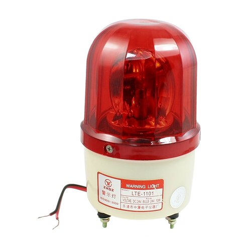

Um what component are you using and what is its current draw? The amount of current it needs will greatly affect the size. Also is it AC or DC???
[quote author=Drew Davis link=topic=217012.msg1586713#msg1586713 date=1392141166] Um what component are you using and what is its current draw? The amount of current it needs will greatly affect the size. Also is it AC or DC??? [/quote]
The component is this, a 24v DC rotating light. Its current draw is 400mA.
I have found some smaller wall warts so I guess I'll just grab one of those.

hmm. I’m looking to switch this device with a solid state relay because I am very keen on the ability to just drive the entire thing from an Arduino pin. But I’ve come up against a weird (to me) thing: the vast, vast majority of SSRs I can see to buy don’t seem able to switch AC voltages lower than 24v? Why might that be? THANKS
.. it will do ! (if 'this device' is a AC to DC adapter) the SSR can NOT switch DC current
The 25A type is cheapest
For 400mA, why not just use a simple MOSFET? Anything sold as a "DC SSR" is going to be a high power MOSFET anyway, like these from Crydom.
http://www.crydom.com/en/Products/Catalog/AdvancedWebPage.aspx?CategoryText1=Panel%20Mount&CategoryText2=DC%20Output%20SSR&CategoryText3=1-DC%20Series%20MOSFET%20output%20-%20Ratings%20from%207A%20to%20100A%20and%20100%20to%20500%20VDC&SBCatPage=
Solid state relays use a triac to allow it to switch AC in both directions.
A mosfet would be more appropriate to switch 24v dc.

Thanks. Would this one cut the mustard?
That one will do. .. I would choose one in a TO220 format for easier printlayout e.g. like this one http://www.onsemi.com/pub_link/Collateral/NTP60N06L-D.PDF

What is the advantage of NTP60N06L over FDP7030BL? THe latter is quite a bit cheaper and SEEMS to be suitable.
THANKS og takk!
Dane: What is the advantage of NTP60N06L over FDP7030BL? THe latter is quite a bit cheaper and SEEMS to be suitable.
Either is suitable for your application. Looks like the more expensive one is rated for 60V operation while the cheaper is rated for 30V.
