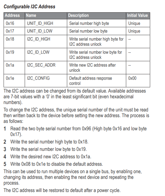

Hello all,
I'm wanting to run two separate LIDAR sensors on the Arduino. In order to do this, I need to change one of the sensor's address (since both devices have the same default address) so that I can communicate with each one individually.
The step by step process is outlined in the manual (which I attached) and I also included screenshot of the portion of the manual that specifically explains the procedure.
My primary stumbling blocks are as follows:
1. It appears I'm suppose to read the serial number from address 0x96, yet each of the two bytes also have their own individual addresses (0x16 and 0x17). As of right now, I'm not even using the low and high byte addresses in my code as I'm little unsure of the distinction between address 0x96 and addresses 0x16 and 0x17.
2. When assigning the new address to the LIDAR sensor (step 4), do I still need to initially use the default address (0x62) at the beginning of the transmission to initially connect and talk to the sensor?
3. It looks like the orange line enables or disables the sensor. So when changing the address of one of the sensors do I tie the orange line of the second sensor to a GPIO pin and drive that pin low? It would appear that I would otherwise be addressing both devices when I'm only trying to talk to one.
Thanks in advance for any assistance or insight anyone has to offer.

 ![Instructions.PNG](https://europe1.discourse-cdn.com/arduino/original/3X/4/6/4603281ebdcb4dd4a63c1bfe9ce83d1cfda38ebd.png)
[User\_Manual.pdf](https://forum.arduino.cc/uploads/short-url/8ZYkVAsROHL2dnqKxsz2qGSFHvz.pdf) (750 KB)

Don't worry about the 0x96 part, the only import pieces are the two bytes in 0x16 and 0x17.
Initially, you do use the default address.
Yes, you would drive the power enable line low to turn the other module off.
<div class="post-metadata">
**Author:** ![Power\_Broker](https://dub1.discourse-cdn.com/arduino/user_avatar/forum.arduino.cc/power_broker/32/226104_2.png) [@Power\_Broker](https://forum.arduino.cc/u/Power_Broker)\
**Post date:** [April 23, 2019, 1:58am UTC](https://forum.arduino.cc/t/switching-device-address-on-a-garmin-lidar-sensor-via-i2c/587577/3 "2019-04-23T01:58:14Z")
</div>
BTW, there is built-in logic to the library to set the address. Just pass the desired address into the lidar class constructor (you might still need to manually shutoff the other module via the power enable line)

Thanks for all the helpful, informative replies. 🙂 I have since made modifications and corrections to my code (which I re-uploaded above) and have a better understanding of what is going on now.
As it stands right now, I'm trying to get the LIDAR sensor to display data with a newly assigned address to ensure that all the register were set appropriately. Right now, I'm getting a "nack" on the serial screen which indicates there still exists errors somewhere in the address reassigning procedure. \>:( I've been trying to troubleshoot this for awhile now, so if anyone catches something erroneous in my code, just let me know.
**Author:** ![rhumphrey](https://avatars.discourse-cdn.com/v4/letter/r/ee59a6/32.png) [@rhumphrey](https://forum.arduino.cc/u/rhumphrey)\
**Post date:** [April 23, 2019, 9:58pm UTC](https://forum.arduino.cc/t/switching-device-address-on-a-garmin-lidar-sensor-via-i2c/587577/6 "2019-04-23T21:58:54Z")
</div>
I got it to work. Turns out I shouldn't include step 5 in my code (disabling the default address) since I'll be using that address for the other sensor.
