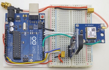

I've posted a relatively detailed explanation of my method of synchronizing the clocks on multiple stand alone RTC's with a Neo6M GPS and an UNO. We needed this for mult-sensor clusters in caves:
With that UNO test rig, SN's can usually be set within 50 microseconds of the GPS pulse, but the -M chips usually set about 1 millisecond before to the time-sync pulse. I have not yet figured out where that negative offset comes from. But some of the RTC's have significant drift rates if you leave the age register set at the default and you can visually detect this within a couple of days based on the timing of LED blinks. So there is not much point in synchronizing that precisely unless you also run ShermanP's Age Register test to get the default drift rate under control. With both precise time-sync and a well adjusted Aging offset, you should be able to get less than a millisecond of drift per day indoors.
Also worth mentioning that HeyPete had no trouble setting a breadboard full of these RTCs via the same I2C bus transaction, or you could try an I2C multiplexer like the TCA9548.

In my sync code, the difference between the RTC and the GPS pulses is shown as a simple subtraction of Tclock - Tgps. If the RTC SQW ends after the GPS the number is positive, but if the RTC square wave ends before the GPS pulse the number is negative. On SN chips the number is a very small positive but on the -M chips the number ends up being about 1msec negative. For that to happen the first square wave out of the RTC after time sync must be slightly short, and I have no idea why that is.
And thank you very much for sharing your age register utility SP. There are now far more -M chips floating around and they really are not that useable without this kind of tweaking. On the Uno rig I can just let that chug away in the background.
To Wawa: Network access is not available at most research field sites on anything like a reasonable battery operated power budget. Heck, the utility electric goes out once a week in many parts of the world. And even when you do have network access I suspect there are a lot of extra hoops to jump through before an NTP sync actually delivers microsecond level accuracy. This is why takes several days to do an RTC drift test using NTP, while it can be done in as little as 30 minutes with a GPS.
