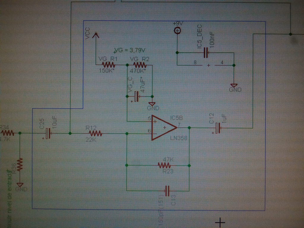

I am reading some material about pcb design and noted what you say is important. But one question about that.
An opamp is used at the output, there one of the inputs comes from a pt2399 delay output and another from a virtual ground. Those two are the traces that need to be of equal length?
Please check attachment
Sorry, I am grasping some new ideas here
Oh ok, sorry. I think that doesn't apply because it's an inverting configuration :-S
Another question then. The atmega328 should be considered as digital ground, and Lm358 is analogue, right?
Also, note that the noise is still there even if I remove all ICs, even the atmega328. So doesn't that discards the bad design problem????
Thank you so much!
It doesn't apply because it is not a differential input signal.
the atmega328 should be considered as digital ground, and Lm358 is analogue, right?
Yes. Although the atmega328 has both an analogue ground and a digital one along with two supplies. So if you have any A/D functionality going on then include these on the digital / analogue splits.
No it still leaves you with layout problems.
