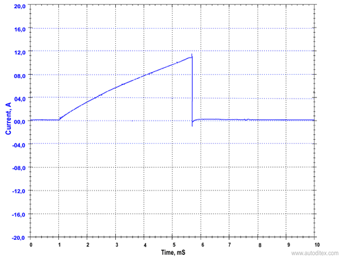

The DWELL function is a bit more difficult.... the output, of course, would write to a DIGITAL PIN, the INPUT would be analog, and would come from a circuit that varies between OPEN and CLOSED states, and the PWM output would be the percentage of time the circuit was CLOSED over the sum of both CLOSED and OPEN time. For example, if the CLOSED and OPEN "cycle" takes 1/100 of a second, and the circuit is CLOSED for 1/300 of a second, the percentage would be 33.333% to drive the meter, whose scale will read zero to 50 degrees. Normal analog circuit voltage will vary between 6v open and approximately 2v closed. I'm guessing I'll need to toss in some resistance before it hits the Arduino's ANALOG pin so if I toss in a 100 ohm resistor I should have voltage the UNO can deal with and then it's a matter of a simple math calculation, right?

No idea why you would use "analog" input to measure the dwell.
Signal from the points would be either closed or open, assuming a small calculation for switch bounce.
Same here. In the case of the test stands (Sun and Allen) they used an ordinary 6v ignition coil, with 1.5 ohm impedance. a transformer & rectifier to step down the voltage from 115vAC to 6vDC.
Since my meters use PWM input and are 0-5v I'm using the digital output from the Arduino. However, since the board will only map input voltages from 0-5v my analog input to the board, from the ignition coil primary, will include a 100 ohm resistor to reduce the input voltage.
Correct me if I'm wrong, but isn't a "digital input" 0,1 (off, on)? How can you input a waveform like the one shown as a digital input without an additional converter?
