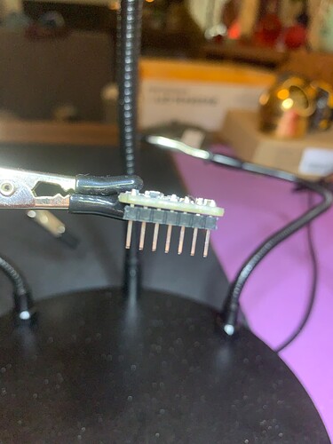

To describe the matter, I soldered the header pins onto one of the sensors, and decided to test what I'd done. And to put it bluntly, something isn't working. It's not just a matter of Arduinos not detecting the sensor, but the onboard white LED does not come on and after being plugged in for less than a minute, the sensor chip becomes very hot to the touch.
I have tested using both an Arduino Uno and a Nano, including trying the I2C detector sketch, which does not detect the sensor using any of the likely addresses I've found online.
I speculate since I am new to soldering that it could be a soldering issue, but no matter how closely I examine the joints, I cannot detect any bridging, and the joints appear to my somewhat-untrained eye to be okay. But if the soldering isn't wrong, I don't understand why the LED doesn't illuminate when powered, and why it gets ridiculously hot to the touch. I hesitate to solder up any more of my stock for fear of ruining them before I identify what went wonky with this first one.

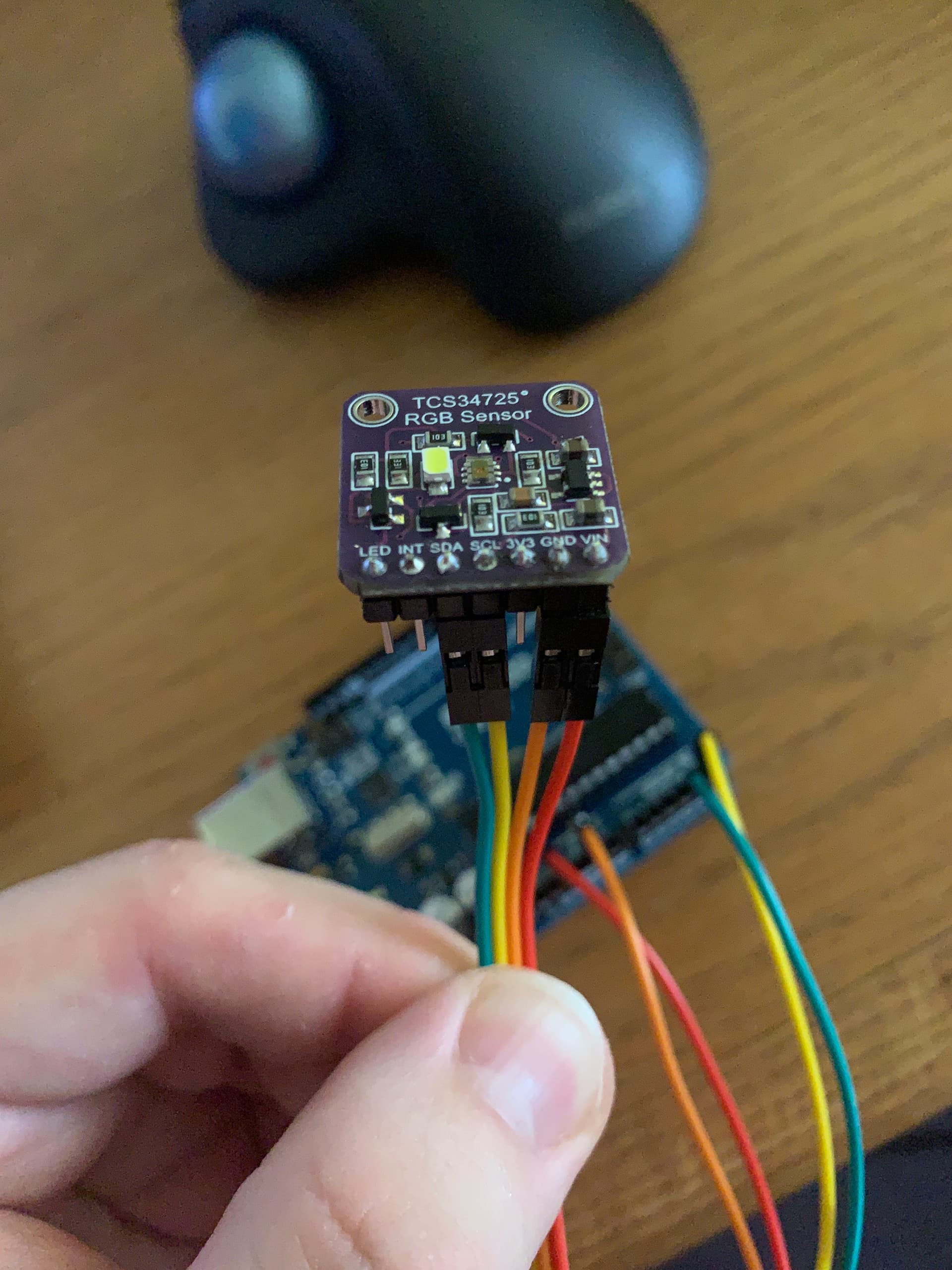

Obviously something is wrong. I'm attaching a couple of pics of the chip and the solder joints. Wiring to the Arduinos seems secondary at the moment, but if that seems necessary I will add that too. I was following the many nigh-identical guides so I am very confident I was using the correct pins.
Any possibility I just had bad luck with my first chip and got a faulty one, and should solder header pins to others? Or was this my rookie mistake? Pics here (as close as my phone would take without getting blurry):
Your solder job looks ok. What we need to see is outlined in the Pinned post you should have read first called 'How to get the most from the forum'.

We need to see how you wired the device, do NOT replicate the instructions, draw your ACTUAL wiring.
Do NOT update, post as a reply your code, and your drawing.
The most obvious cause of the heating is you are connecting a 5V UNO or NANO to a 3.3V sensor. It is likely fried now.
I can accept it being fried, but I will reiterate that the datasheet for this sensor says it can accept either voltage, it has pins for both, and (again, you only have my word but I swear I'm being honest here) I ONLY ever connected 5V to 5V or 3.3V to 3.3V. I have read enough horror stories on forums like this one about voltage mismatches so I was meticulously careful to not do that.
I have no formal training, I'm a beginner, I apologize but your request for me to hand-draw a wiring diagram just is not going to happen. I don't have the know-how to do what you want there. I don't know what to make of your insistence not to replicate instructions, as being a newbie I have nothing else I can do other than follow directions I find (such as the ones I found here: Interfacing a TCS34725 RGB Color Sensor With Arduino). Unless that's not what you meant here, but that's what it sounded like.
What I can do is add here the pics of the sensor and Arduino as I have it wired. And here is also my code, which, again, just nothing custom, it's literally the example sketch that comes with the library. But if it would be helpful...

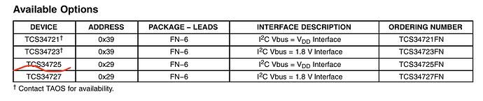

Here are a couple of screen grabs from the datasheet for the
TCS3472(5)
Notice the Recommended line 1 is for the TCS34725 and states that the I2C pins (SCL, SDA) MUST be 3VDC.
Both the UNO and NANO pins for SCL and SDA put out 5VDC.

YEP, that will fry the sensor.

This then is not aimed at you, more of a shaking-fist-at-sky moment, but why is this the exact wiring layout literally every article I can find about this sensor demonstrates? Seriously, I've spent a few hours researching this sensor and I NEVER see anything other than this exact layout.
So if that's the problem, then, again understanding you're dealing with a newbie who's genuinely trying to learn and fix it, what kind of tweak will I need to connect to the SDA/SCL without frying it?
So does my other scanner. Never mind, the datasheet has the address for the type 5 and it is 0x29
First give me a reputable link to instructions that say it is ok to use a 5V UNO or NANO with a 3V device. Maybe there is something subtle you or I missed.
The product page does not state that the module is 5V tolerant. Here is what it states, which is incoherent:
Voltage Levels Compatible with VDD or 1.8 V Bus
If the chip overheated, assume it is dead, regardless.
