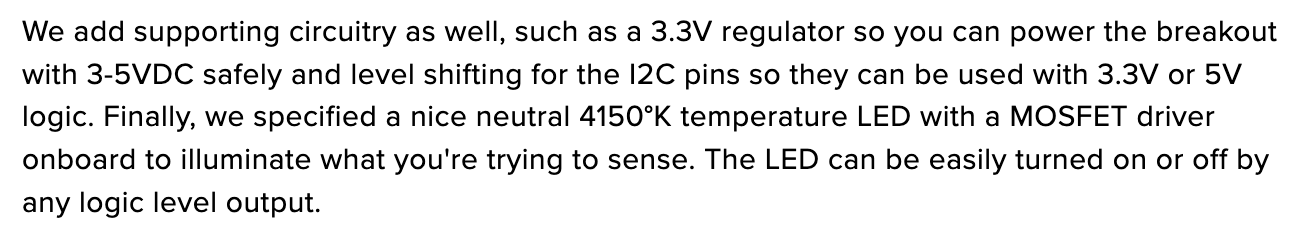

Here is some info from a reputable supplier Adafruit. NOTE this sensor is NO longer stocked.
That is why their products are a bit more expensive. You get what you pay for.

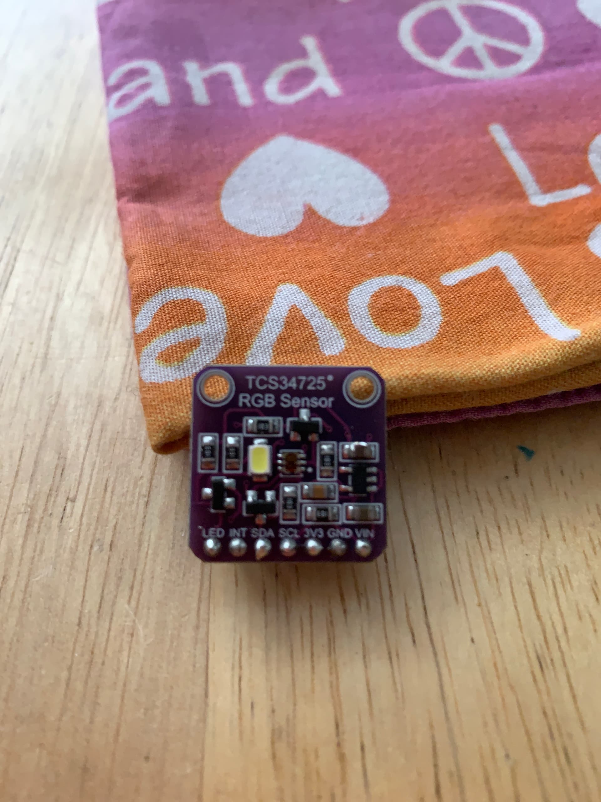

Looking at the sensor you posted an Amazon link for, the picture looks like there may be a 5V to 3.3V voltage regulator. If you use a lit magnifying glass see if you can read the 3 legged devices near the I2C pins (SCL, SDA)

Here is the VR

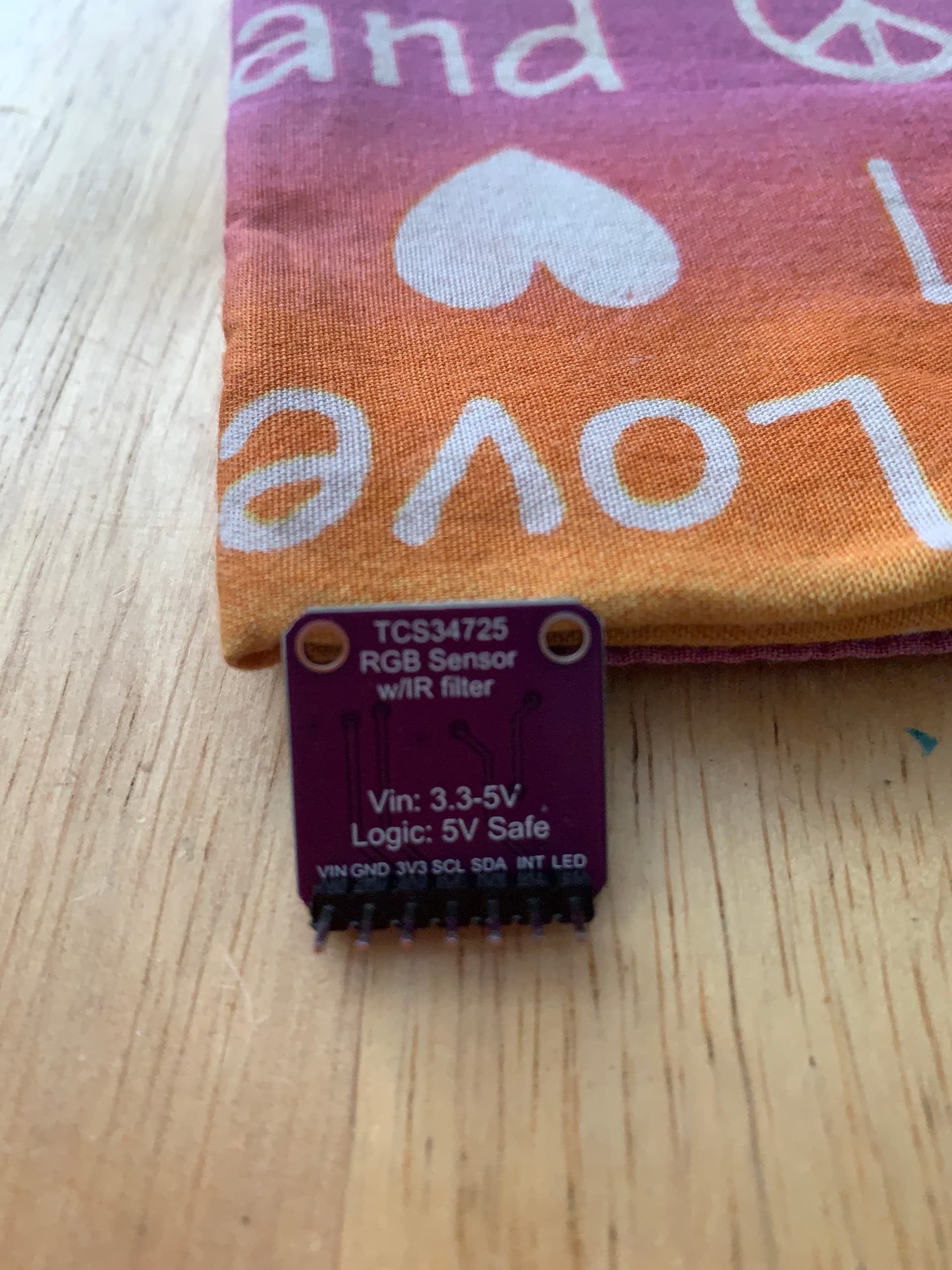

Those are both Adafruit sensors. Yours is not. Take a photo of the sensor as full frame as possible without getting blurry.

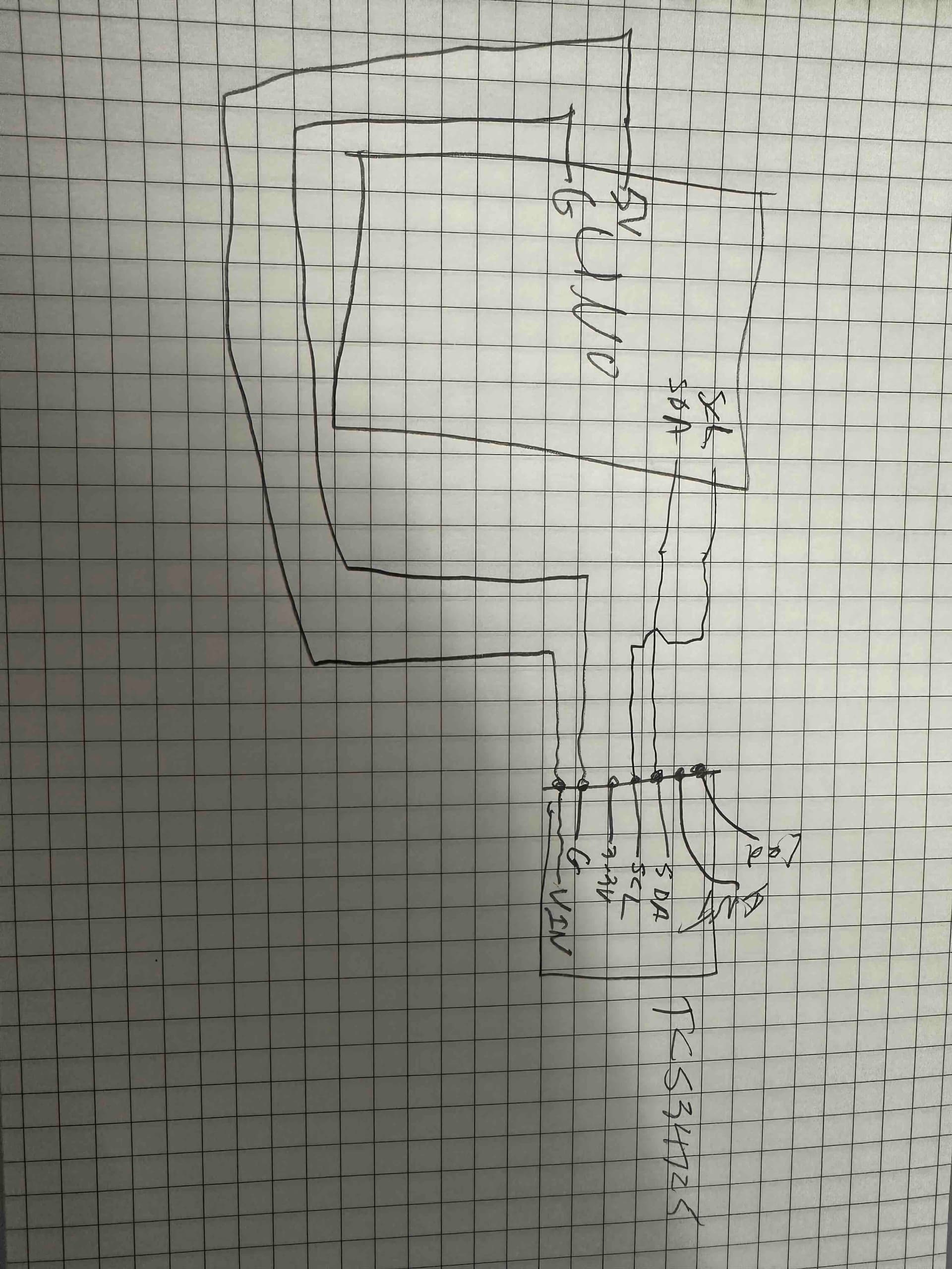

Here is a hand drawn wiring diagram.
OK, just snapped these pics.
I would like to note in my own defense that if you look at the pic of the back of the chip, the printing explicitly states both that the Vin connection takes 3.3-5V, and also the Logic connections are "5V Safe". I'm not doubting that the general assertion of the chip being fried are accurate, but the chip itself purports to be capable of handling 5V all around. If that's wrong, it's not just digital documentation or a third-party website or even my assumptions, it's literally printed on the chip itself. Would this indicate more just a knockoff chip quality over an actual error on my part with connections?

I suspect that sensor is ok. The problem is the datasheets I and others are highlighting are correct in that the sensor is 3.3V BUT BUT BUT if you look at the 'board' you will see a black chip with 3 silver legs, 2 on 1 edge 1 on the other. I will make a medium wager that is a VOLTAGE REGULATOR that take in 5VDC and puts out 3VDC or 3.3VDC
There are 3 chips like that on the board, one above the LED pin, one above the SDA pin and one up top by the word Sensor.
If you can look at the 2 chips near the SDA pin and get the part number it would confirm my hunch.
Now my hunch as I am not trained and am an 83yo autistic person but how does the VR work with a 3.3VDC board? Normally the input Voltage needs to be a volt ot two above the output. I think I saw in the datasheets that the output only needs to be 1.8VDC so that would explain the 5 or 3 statement.
Here is what worries me. This chart shows a TCS34727 as using 1.8VDC while the TCS34725 uses VDD which is probably 3VDC or 3.3VDC it will NOT be 5VDC.
I did my best with my illuminated magnifier, but those are tiiiiiiiny and my 42-year-old eyes couldn't make out much more than scratches. My brain kept wanting to say it looked like "Rin" but that wouldn't make sense, so I'm guessing it's just too tiny for me to see without maybe busting out my DSLR with a macro lens.

As far as I can tell, it was Adafruit that added the 5V to 3.3V VR on their board. I doubt the native part has that.
I am pretty much convinced you did not toast the board, and also sure that we understand how the 5V vs 3.3V is being done.
So we are back at step 1.
Did you try swapping the SCL and SDA wires?

I did not swap them, no, and now I wish I had brought my Arduino stuff with me to work today, but I did not, so I'll have to wait for either tonight or tomorrow to test that. Apologies for the sluggish pace of working through this, I just have my primary workspace at home (despite this being a project ultimately for work), and I don't always bring my Arduino stuff with me if I don't foresee having anything to work on.
I'll give the wire-swap a go at my next opportunity! Thanks for your patience!
