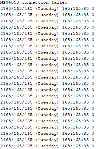

Attached is a picture of my Serial monitor
As you can see, the MPU6050 is not starting up and the RTC is not working either.
If I remove one part, the other one works. However, they do not work together.

I guess you don't use the MPU6050 chip directly but by some breakout board. Provide a link to the schematics of that board and also to the schematics of the RTC board. You need pull-up resistors for the I2C bus but these pull-ups must be used only once in a bus. So if both boards have pull-ups soldered you might have to desolder them from one board.
Also the MPU6050 is able to change it's I2C address but you must pull pin AD0 high to activate this. It doesn't listen on both addresses at the same time.
