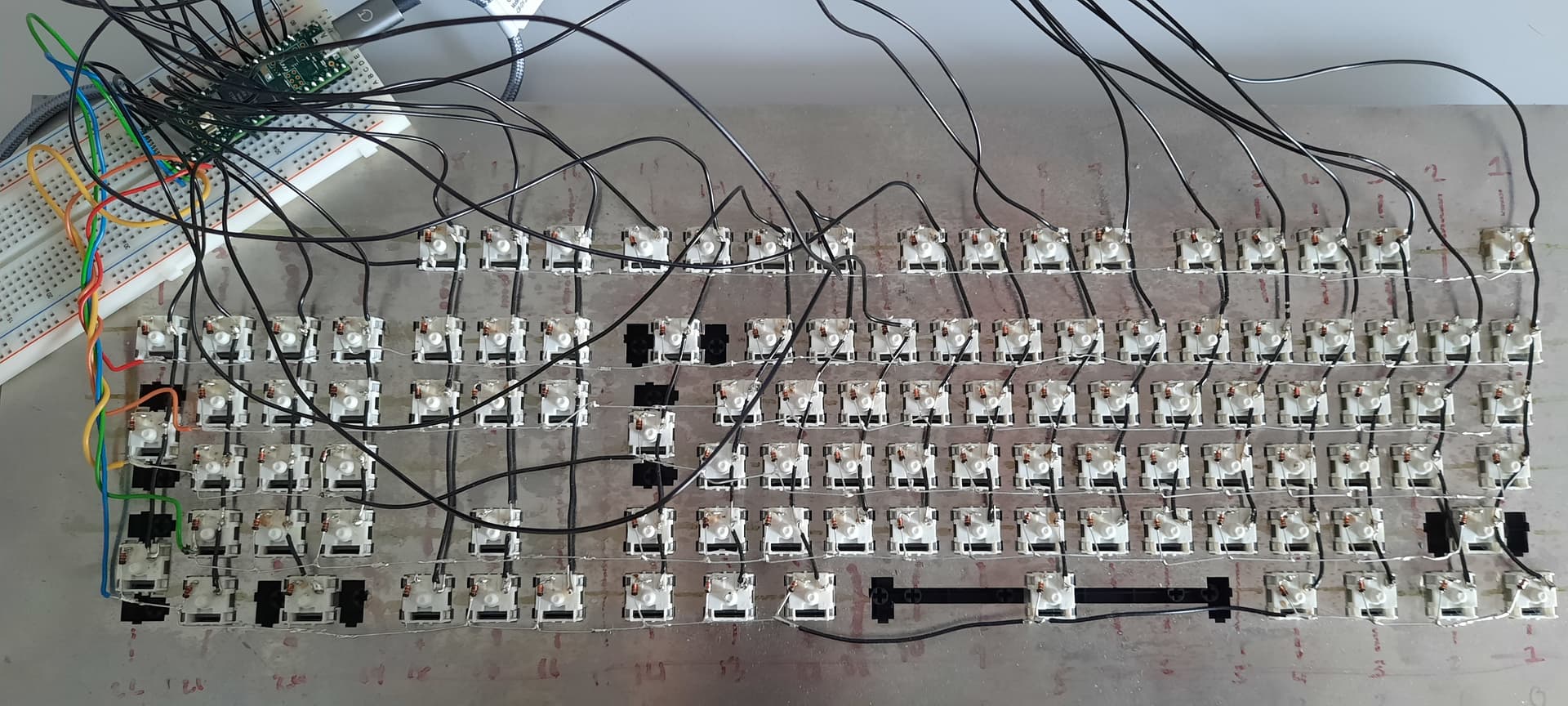

I'm trying to build a keyboard using a Teensy 4.1. I've tried running a few different firmwares I found online but had a problem where the keyboard would output both the key pressed and the key on the row beneath.
There's no obvious shorts/problems in the hardware side of things, so I wanted to check if the problem was in the code I was running. I wrote some short code to print out if a key on a specific row was pressed, with the plan to check each key press outputs the intended row/column pins. In the Arduino IDE, board is set to Teensy 4.1, USB type is "Keyboard".

each key should be in serial with diode
https://www.gammon.com.au/forum/?id=14175
Thanks for replying. Each key has a diode and is wired like the example. Here's a photo of the wiring (picture wouldn't upload directly)
I ran the debug code from that link and it is showing two key presses for each key pressed. I took the other row wires out of the teensy to narrow down a potential short but still it still registers two key presses.
are you sure the naked row wire is not touching Alu plate?
I don't see any place in sketch where you activate column one by one and read bits in the row.

Definitely no continuity between the diode rows and the plate, nor the diodes and the black wires. No continuity between rows either.

Here's what I've done so far:
  • Checked for shorts/continuity between teensy pins
  • Tested all diodes
  • Ran test code with only one row and one column connected, still getting ghost key presses. Same for all row/column combinations I tested.
  • Swapped row/column assignment in sketch (read some other threads where this was the issue). This gave no output
When I press a key on the bottom row, it's also registering a key press on the top row. I think this would indicates that it's not due to shorts
There are some inconsistencies though, such as:
  • Pressing key 9 registers key 31 9 times
  • Pressing key 33 registers key 55 repeatedly until released
  • Some keys register only the correct key
  • Sometimes the key incorrectly triggered doesn't physically exist in the wiring matrix
Could this be a problem caused by having different numbers of keys in each row? I thought this was necessary due to the layout of the switches.
In one column I only have one key, due to ease of wiring the columns. This always triggers the correct key press. Does this indicate problems with my matrix wiring?
I've just tried taking the column with the single switch out of the equation but no difference.

The Teensy 4.1 uses the IMXRT1062DVJ6 MCU. I checked the datasheet and the pullup values for GPIO are listed as 22K or 47K or 100K.
Various keyboard designs normally use 10K pullups, some use 4.7K. Some designs use series resistors on the rows or columns (depending on ckt configuration) to deal with issues when multiple keys are press. Also would greatly reduce "ringing" on the signal, as this is a very fast MCU.
I would recommend using 4.7K external pullups on the colPins and series connected 470Ω resistors on the rowPins (preferably located at the output pin).
Overall I'm this should significantly reduce ghosting/crosstalk/ringing. Just need a couple of resistors to test one key to see what happens.
You declare Row as a variable (global).
Your loop --
  digitalWrite(rowPins[Row], HIGH);
  Keyboard.print("Key on row ");
  Keyboard.print(String(Row));
  for (byte i = 0; i < NUM_COLS; i++) {
    if (digitalRead(colPins[i]))Keyboard.println(" not pressed");
    else Keyboard.println(" pressed");
  digitalWrite(rowPins[Row], LOW);
  Row++;
  delay(10);
Row gets Incremented each pass through, but it looks like it never gets
set back to 0 (after the 6th iteration). So, --
  Row++;
  if(Row > 5)    // Reset Row
    Row = 0;     //  Now Re-cycling
  delay(10);
This has fixed the problem for about half the columns, thank you. I'll try 10k to see if it fixes the others.
There's some ghosting when keys are pressed quickly or multiple key are pressed but for now I'll put it down to the code, since it's just a test program. (Running the code prev posted from gammon.com)
