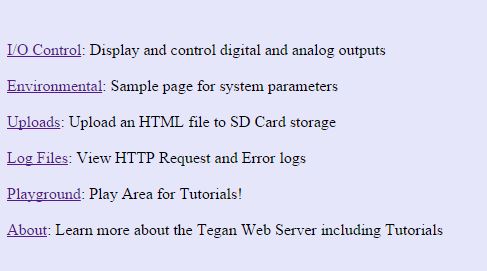

So the following HTML snippet added to your web page:
HOME TEMPERATURE
The temperature in the living room is: <%SL0> Celsius
would result in:
HOME TEMPERATURE
The temperature in the living room is: 23 Celsius

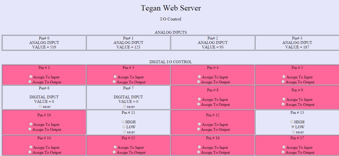

Analog Readings and I/O Control
TeganWS provides an I/O Control page which displays the Analog Input readings and has radio buttons for configuring, reading and writing all the digital I/O pins for easy configuration and breadboarding directly from a browser. Uninitialized pins are color-coded for easy identification.
See the attached TWS-IO.JPG for a screenshot.
