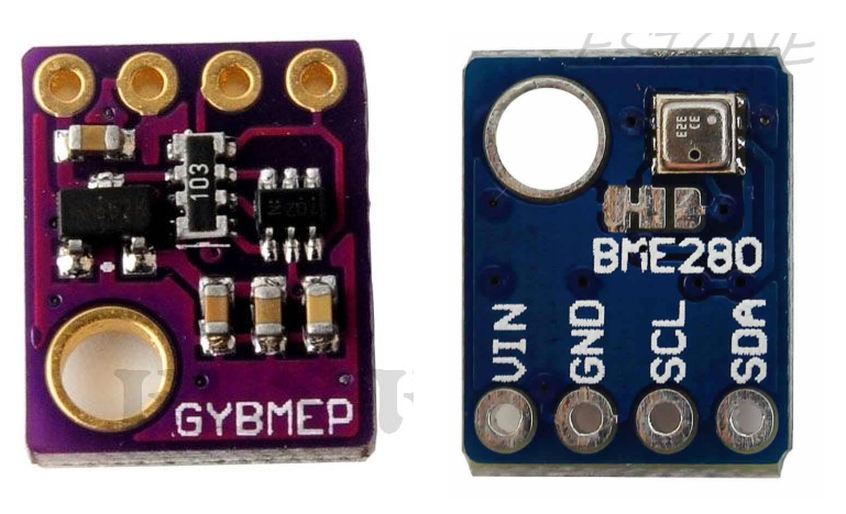

Found the BME280 by Bosch is a serial I2C or SPI chip that does RH and temp AND absolute pressure
numbers look interesting. there is a newer version, one with a MEMS gas sensor, but it was released in Feb 2016, still not available in distribution channels.
CAREFUL !
both are the same cost on E-bay, but one appears to have a voltage regulator.
the BME280 itself is a 3.3 volt device !!
Supply voltage VDDIO 1.2 - 3.6V
Supply voltage VDD 1.71 ... 3.6 V
SOME suppliers (adafruit) offer level shifting, voltage regulator, etc on the board.
the pics are from E-BAY and are very questionable.
I see the front of the board AND back in some ads, some just the front.
makes me concerned that some suppliers are just the chip, no level shifting, no VR.......
