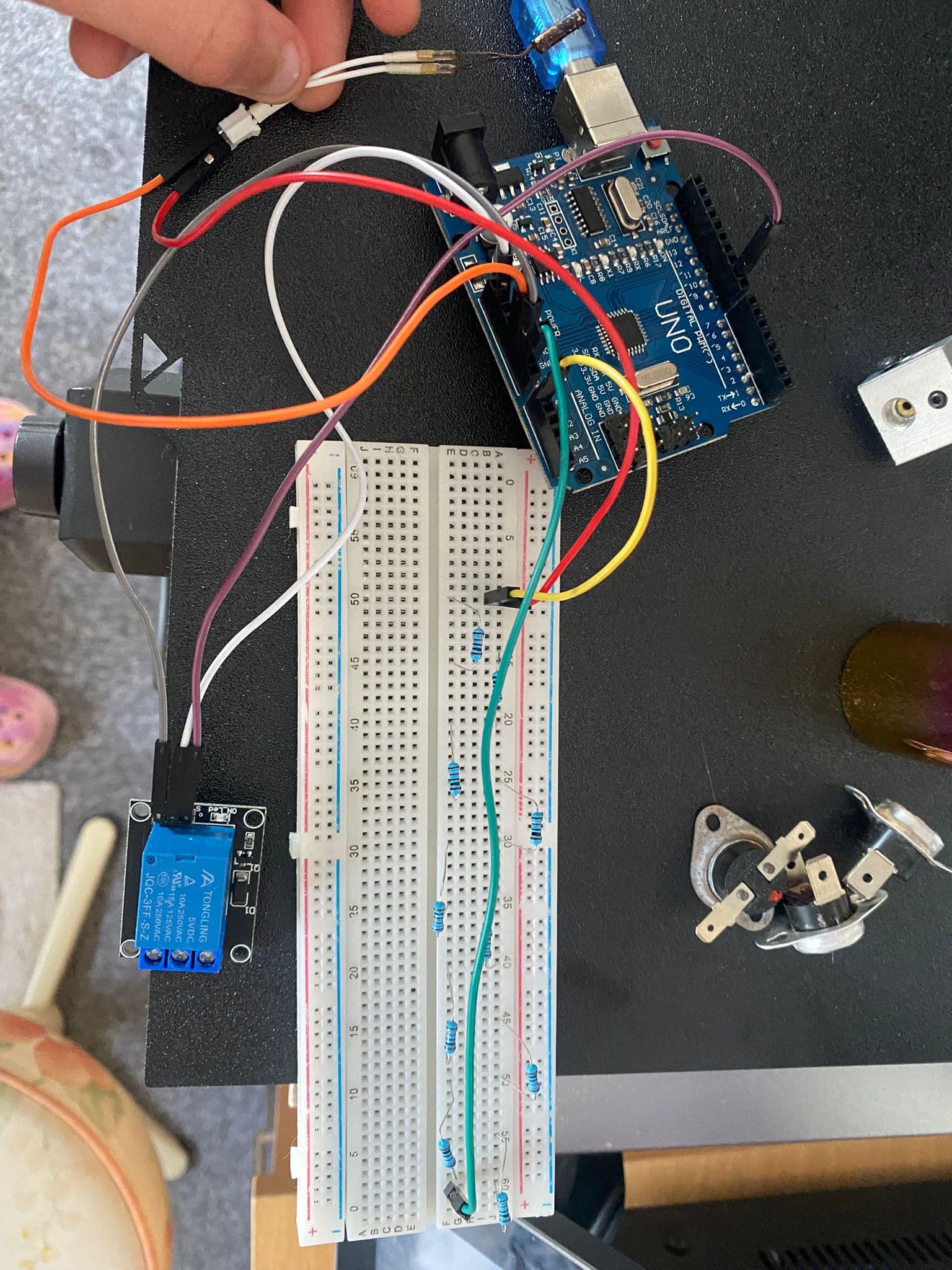

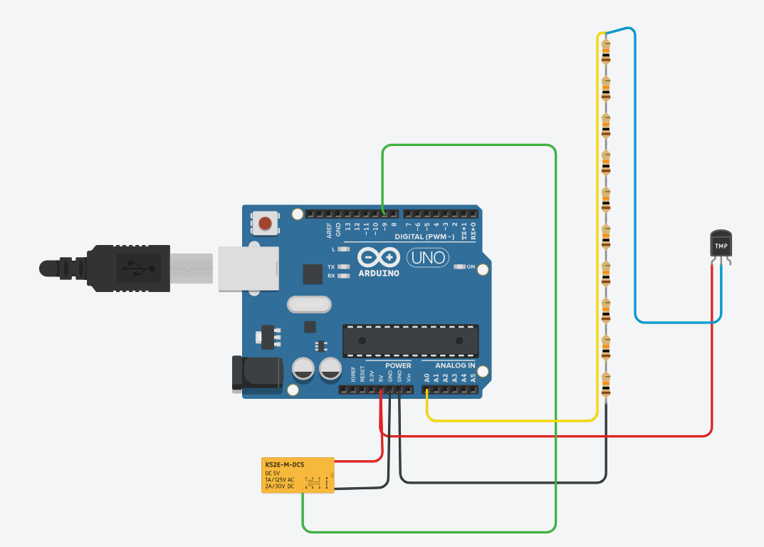

Hello everyone who want to help me i have been trying to de bug my thermo relay im using chinese arduini uno atmega328 core 10 10kom resistors 100kom termistor and 5 vdc relay.
my scheme is working but when im trying to make relay turn off after the temperature reaaches 200 degreee celsium but it doesnt show temperature correctly (i know how to fix that) and when it reaches something around 120~150 degree celsium the arduino uno takes 5~10 sec and that is very anoing i need it to turn off as fast as posible and turn back on when temperature drops 5 degree lover the set temp.

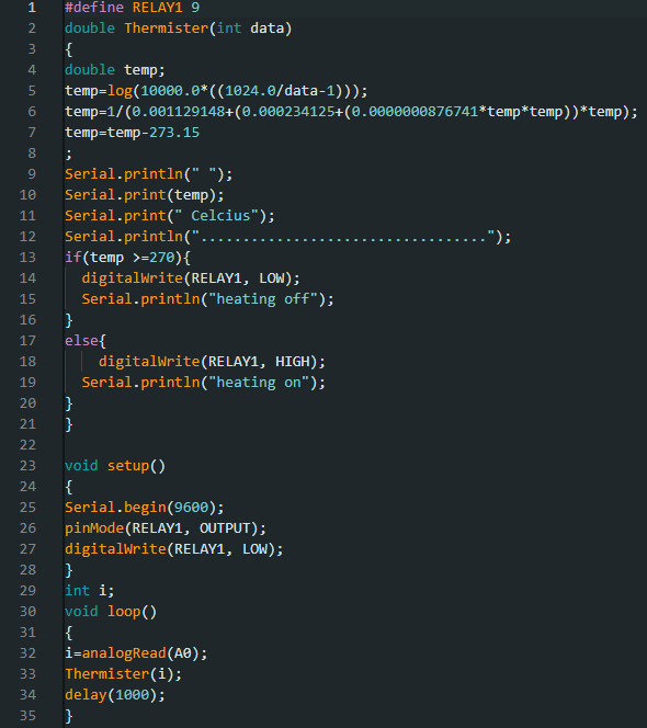

> [@ardduino\_noob](#):
Your code is checking for 270, not 200.
How is it incorrect and how will you fix that?
5~10 seconds to do what?
There is no test in your code except the 270 test.
Perhaps your English is so full of mistakes because you are very angry and frustrated. If so, please take time to become calm before you post again. If you are calm now, then maybe you should use an on-line translator so that you do not have to write in English.
Please read the forum guide before you post again.

im sorry im only learning english so its not the best
it takes 5 to 10 update the temp data
<div class="post-metadata">
**Author:** ![ardduino\_noob](https://dub1.discourse-cdn.com/arduino/user_avatar/forum.arduino.cc/ardduino_noob/32/1179114_2.png) [@ardduino\_noob](https://forum.arduino.cc/u/ardduino_noob)\
**Post date:** [May 13, 2025, 7:12pm UTC](https://forum.arduino.cc/t/termo-relay-on-arduino-i-need-help/1381244/6 "2025-05-13T19:12:37Z")
</div>
it is checking for 270 because i reset the thing that make it show right so for now it is 270 but 200 in reality

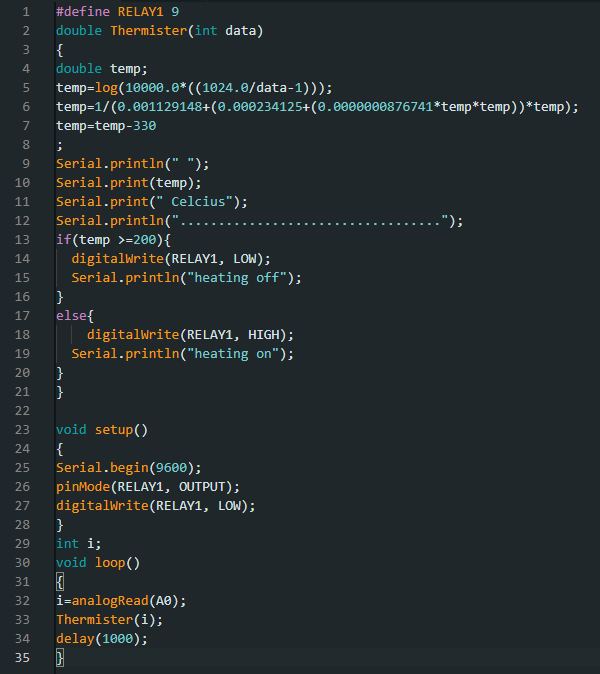

![Знімок екрана 2025-05-13 201354](https://europe1.discourse-cdn.com/arduino/original/4X/d/e/4/de421610ce8cc14b15b096527b96216943b50c54.png)
i swap temp=temp 273.15 to 330 on line 7 and it makes it display 200 degree but it shows incorect temp if it below 180 and more that 240
and i swaped on lin 13 temp from 270 to 200

Which sensor are we talking about.
I think I see some black tube, but I also see clixons (thermal switches).
The string of 10k resistors might be wrong for a 100k thermistor.
We normally use a pull up resistor value of the thermistor value **at the temp of interrest**.
A 10k pull up resistor could be better suited for a 100k thermistor at those high temps.
Leo..

i didnt have the right resistors i connected 10 10kom resistors to get 100kom
> [@Wawa](#):
> [@Wawa](#):
what do you mean?

Post#1 shows a 2-wire sensor, post#10 shows a 3-wire sensor.
So what do you have.
> to get 100kom
Why 100k.
Using 100k with a 100k thermistor is a bad idea when you need to measure high temps.
Leo..

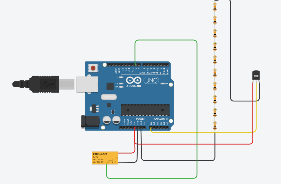

![Знімок екрана 2025-05-14 072218](https://europe1.discourse-cdn.com/arduino/original/4X/d/b/f/dbf360de0ad399919d8ea761a2210a42b4726a32.png)
I apologize i made a mistake in diagram the termistor was wired wrong way

Is that the correct temperature formula for the thermister you have or is it just something you copied off the internet?

Hi, @ardduino_noob
Welcome to the forum
Can you please tell us what your native language is?
For the relay, draw a box and label the points that the wire go into it.
 ![image](https://europe1.discourse-cdn.com/arduino/original/4X/7/4/a/74a100701186dc856a2846cd68289b16af962a65.png)
A similar box for the UNO.
Please forget about using Fritzy diagrams.
Tom.... 😃 👍 ☕ 🇦🇺
