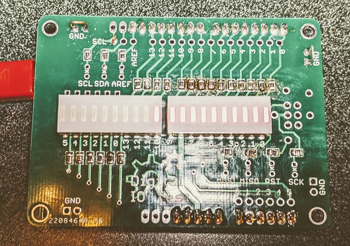

This would be an interesting "shield" to develop, with a selftest program for the mcu. I probably could not justify the cost in time and material, but maybe a teacher with buckets of Arduinos to pass/fail before the next session might realize time saving.

Testing "all functions" would be pretty difficult. But the pieces likely to be bad in a board that will load and run software are less; pretty much just the circuitry associated with IO from the pins.
I did make this "test shield", but it was aimed mostly at making sure the PCB, assembly, and "core" were correct, rather than looking for chip damage.
This is a very nice piece of code, if a tweak it I might develop the test for just the Uno and the Nano.
