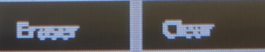

It suppose to be like this instead tft.loadFont("NotoSansRegular9", LittleFS); and it works "fine" like that but the issue is that every fonts looks very bad.
edit: i ended up using the create font option in the Processing software tools with smooth disabled, instead of the TFT_eSPI Create_font.pde. it works fine.
You can convert any ttf with this tool and it works flawlessly.
Cheers.
https://rop.nl/truetype2gfx/
