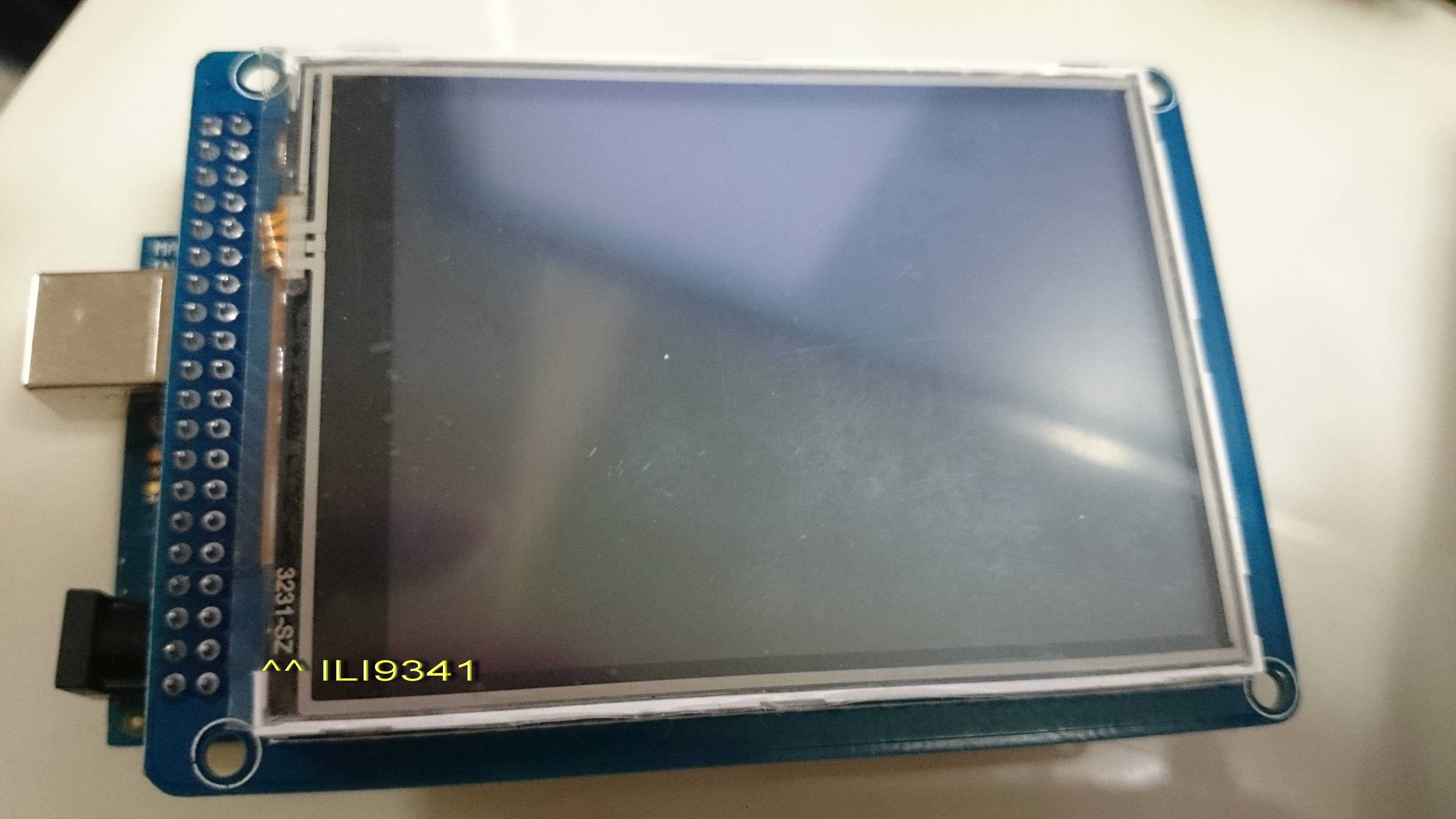

Hey,
I bought the TFT-LCD from our local store with "ILI9341" marked on it. I bought 3 of them. But 2 are ILI9341 and one SD1289. And the wired part is when I look for the lib on the web is always say this LCD is equipped with SD1289 controller.
http://us.100y.com.tw/searchdata.asp?searchType=PNoName&w=3.2TFT-ILI9341&m=any
The different between SD1289 and ILI9341 can be seen both front and back side
ILI9341 with 3231-SZ and SD1289 only with 3231 on the left-down corner.(only show ILI9341)
Front side of ILI9341
Imgur
ILI9341 with TFT-320QVT_9341 and SD1289 only with TFT-320QVT on the right-down corner.
Back side:
Imgur

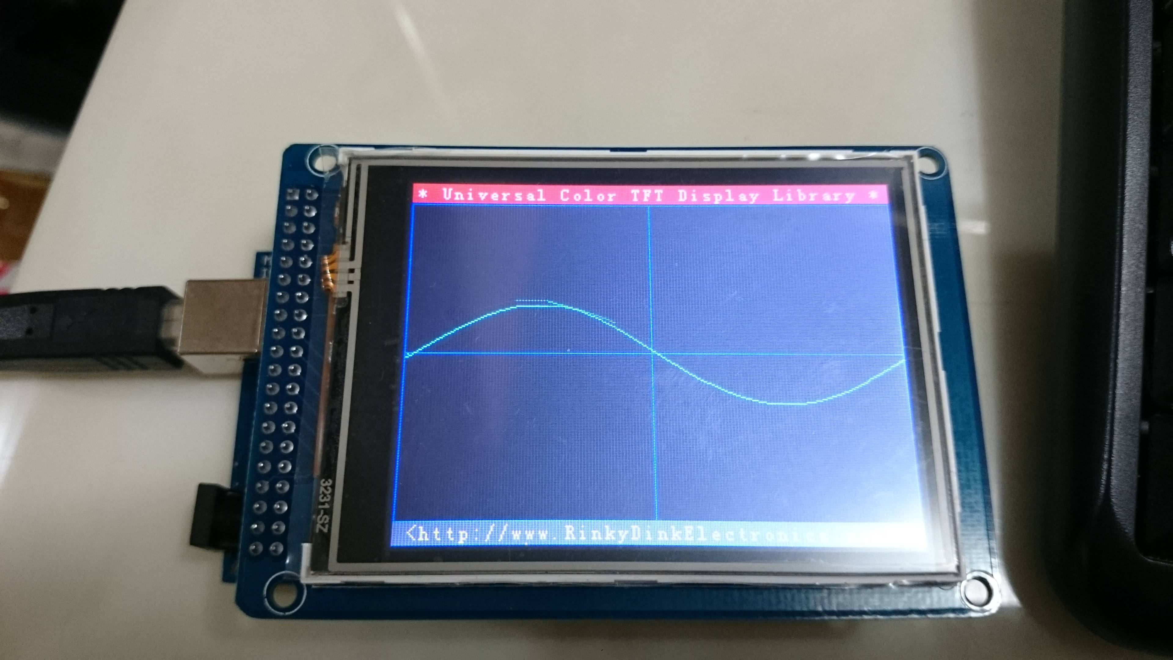

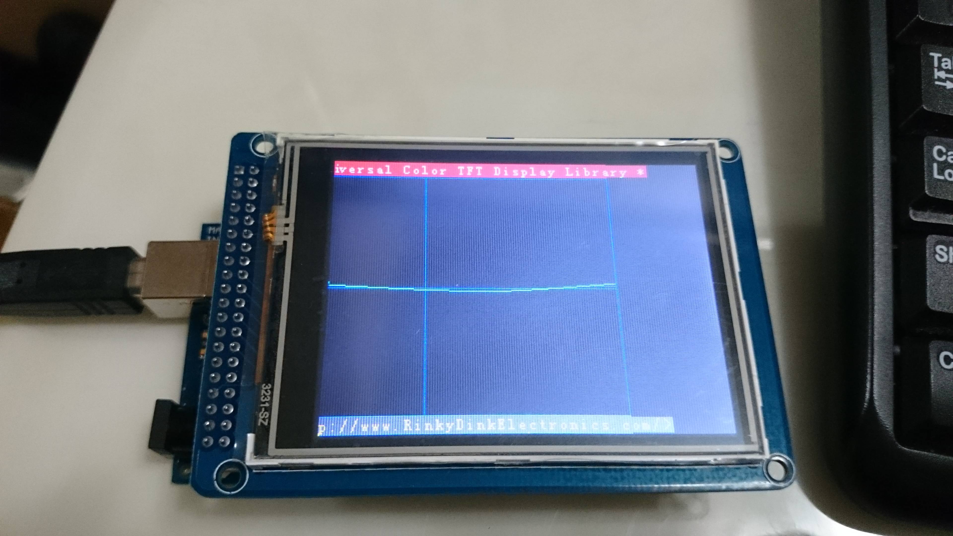

Before modified UTFT lib
Imgur
After modified
Imgur
The part code I modified with red mark
Imgur

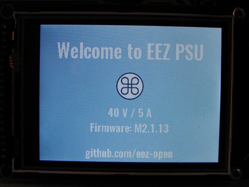

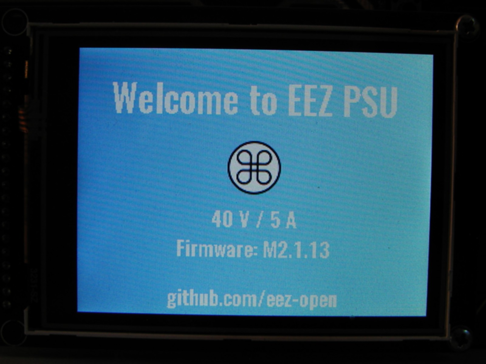

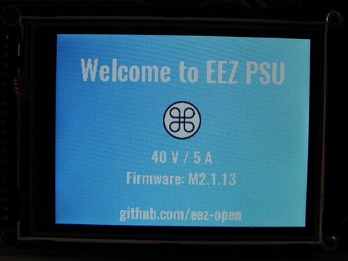

I tried what is suggested in #23 and it works but it's not optimal. Colors looks washed out and pretty distinctive vertical line pattern is visible on the screen. I tried to capture that with my photo camera with limited success:
Fortunately ITEAD put on GitHub a week ago a new library that seems to works directly (and correctly) with ILI9341. Screen colors looks way better (possibly the best that this display can provide) and vertical line pattern disappeared completely (the background color is smooth and even):
