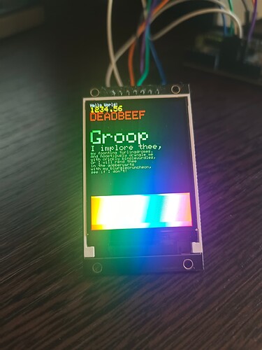

The 320x240 display does not fully work with the Arduino_ST7789_Fast library
The bottom of the display should be black.
Please suggest a solution to the problem or the same fast library for my display.

Your method helped to fix the problem but a new one appeared. The screen doesn't clear normally, just the top part, looks like it's overflowing. How to fix?

The example is called ST7789_AdafruitBenchmark.
Only the top part is erased.
I suggest that you stick with 240x240 and CS_ALWAYS_LOW for the moment.

I rewrote the library for myself. I rewrote fillRect now it calls writeMulti twice, each call to a different side of the screen and this prevents the uint16_t variable from overflowing. fillRect was used to erase the screen in the fillScreen function. When I say function I suspect a method.
Yes, that should solve the uint16_t problem in fillRect().
