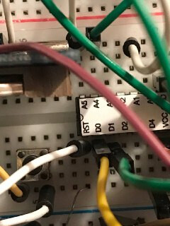

I am making a sensor that works with an ATMega328p to measure the voltage of a panel and send the data wirelessly via an XBee, to a computer.
I'm already in the testing phase and I just need to integrate the programming in the microcontroller to be able to test the whole sensor mounted on a breadboard.
How does the programming or sketch work?
This programming is made so that it is in an infinite loop until a signal is sent from the computer. Once this signal is received by the XBee, the system goes out of the loop and starts sending data periodically.
The problem:
When sending the signal from the computer to the sensor it does not react.
What have I done?
Using Digi's XCTU software, for the Xbee, I found out that I can do an antenna scan and detect the surrounding antennas that belong to the same channel and ID. And the antennas can communicate with each other, which leads me to believe that it is not an antenna failure.

You haven’t shown how you have connected it all up but I guess you have understood that Rx and Tx are crossed over between devices.
Xbee have 4 pins GND (blue), 5V(red), Dout(green), Din(yellow)
And do the two test, TX - Din & RX - Dout and TX - Dout & RX - Din.
I dont have any results.
And I tested If the program really upload in the ATmega328 and yes because, befores this I uploading a Blinking sketch and works.
From the picture, it appears that pins D2 and D3 of the MCU chip are not connected. This conflicts with this:
It looks like you are using the wrong serial connections.
