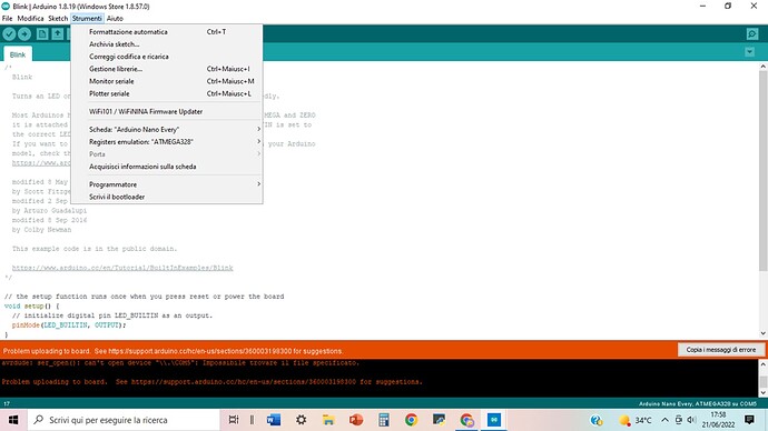

Hi everyone!
Thought the board is connected to the computer correclty and in the right bottom corner of the sketch there's written "Arduino Nano Every, ATMEGA328 on COM5", the port list is void and it can't compile.

What you see in the right bottom is what you last selected. The com port is probably from another Arduino that you used before.
What does Windows device manager think of your board? If it doesn't show there, you might be using a charge-only cable that doesn't carry data. Try different cables; the ones that you use to download e.g. pictures from your phone to your PC (assuming they have the same connector).
It works, thank you a lot
