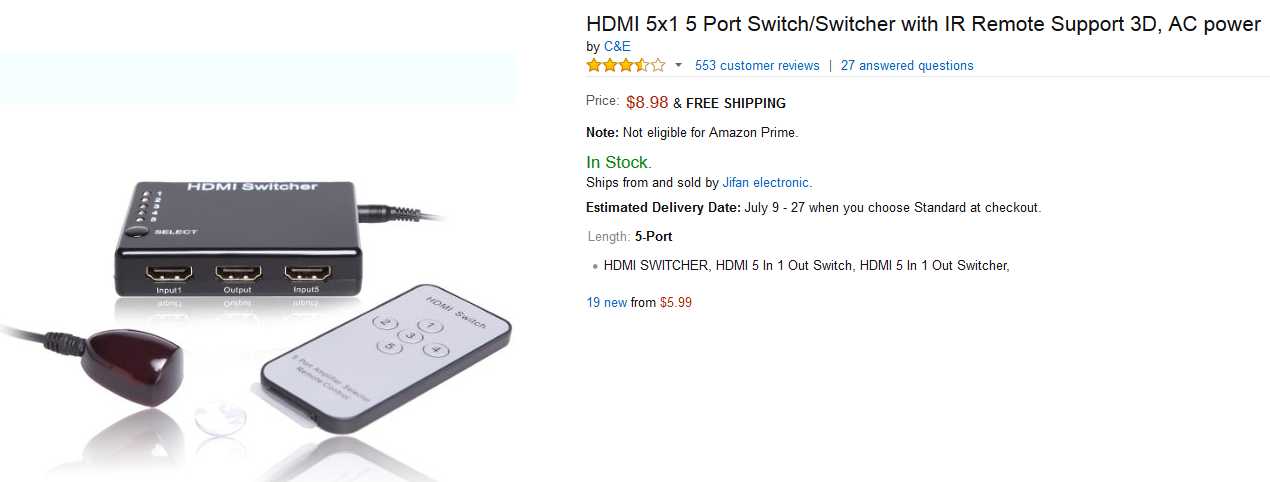

I can't help with your actual question, but I'd suggest posting the details of your switch here. You never know, someone may have experience with that one and know the IR protocol.
https://www.dropbox.com/s/oalm3cus0lwkb6t/HDMIswitch.jpg?dl=0
Why don't you just type the details.... or attach the pic? (You have to do a "full" reply not a "quick" reply to see the "Additional options" below the typing area, and attach there.)
I just did. I went to Amazon got the details. Captured the page uploaded to dropbox and gave you the link. If I need to do more!!, just let me know.
I got it from dropbox, but that's not what I meant. You could just attach the pic to the post in Additional Options.
(You could also, of course, just have given the link to Amazon 8) )

Visit the forums where universal remote control codes are discussed (OFA, Pronto, Harmony).
One file which could match:
No-name Chinese 5 port HDMI switch
This one uses the NEC1 protocol (PID=00 5A), the codes can be found in the attachment.
For more details to understand what to do with the contained codes, you have to use the Remote-Master V2.03 Program and the information from the Hifi-Remote Forum.
To send code, you could look at the IRMP / IRSEND project.
which can send and received codes (text is in German).
The links will help you to solve your problem, but for such a cheap device, I would just buy a new one :slight_smile:
