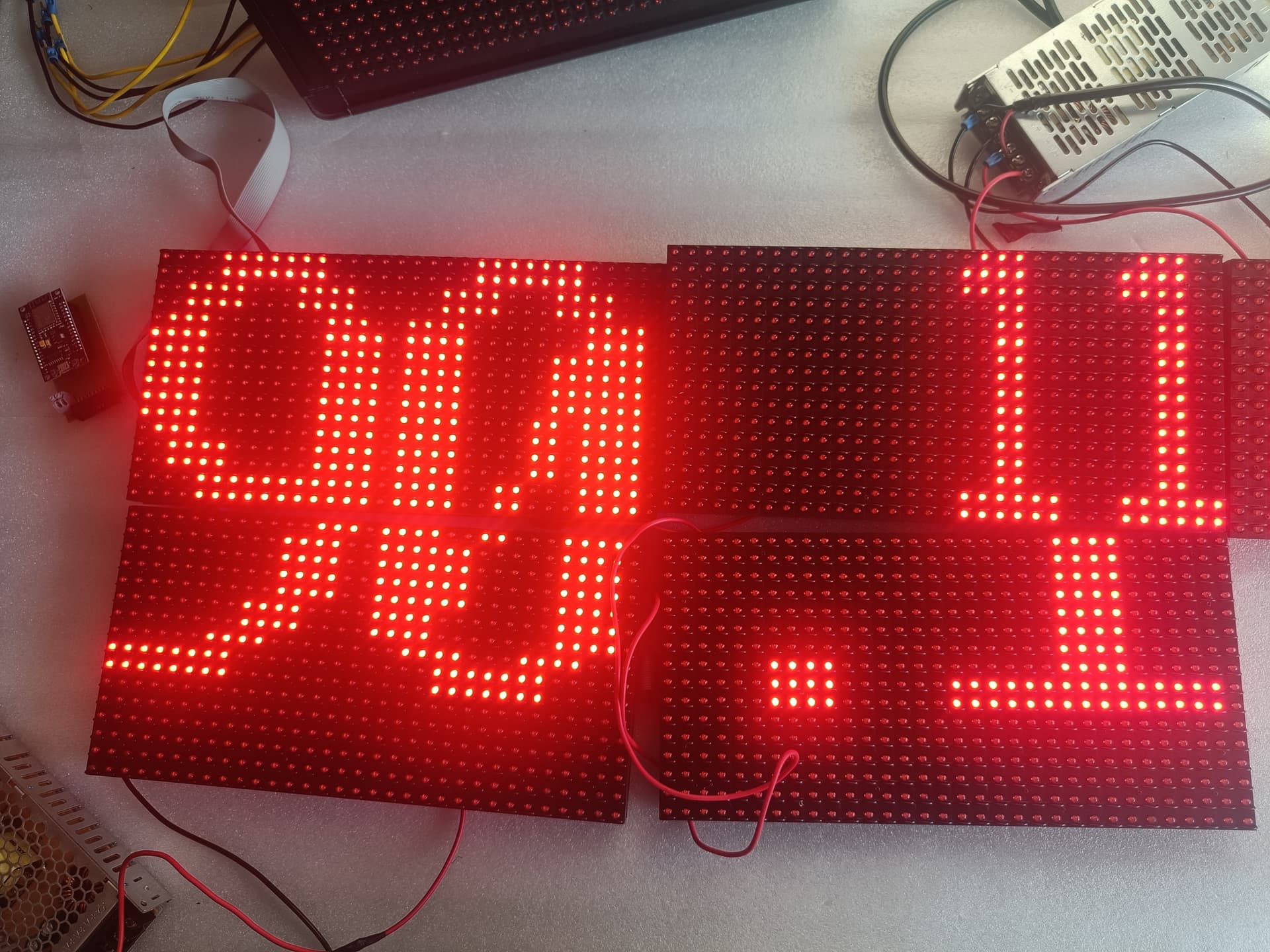

The font configuration issue for p10 led board

As you can see the size of before "." is 32 and after '.' is 16 but while displaying it on p10 board the after '.' show of size 31 and 16 both,
Eg see the image i have provided before and I am displaying 90.11,
90 is of size 31 and 11 is of size 16 but 11 is coming in size of 16 but if you see below 11 there is some part still getting displayed of size 31 the thing displaying is half '1'.
Code snippets are not useful, please show a full code.
What the HUB75 library do you use and on which controller?
@b707

Here's the full code for it
What do try to achieve with adding a float to index? Substring index can be only an integer.
The line below obviously contains a error:
according to it, the width of 3-char string will be less than 2-char string.
In general, your code is just a overcomplicated mess. Your functions for ro1 and row2 are very similar. I would be better to code a common function, where row will be input as parameter.
I would recommend you start from writing a short code, that just to print your string "90.11" with two different fonts.
@b707
thanks for your response but i have solved the problem
the problem was in here
       Disp.setFont(fixednums15x31);
        Disp.drawText(x, -17, Fuels[currentFuelIndex]);
I did not mention the different fonts in this part
