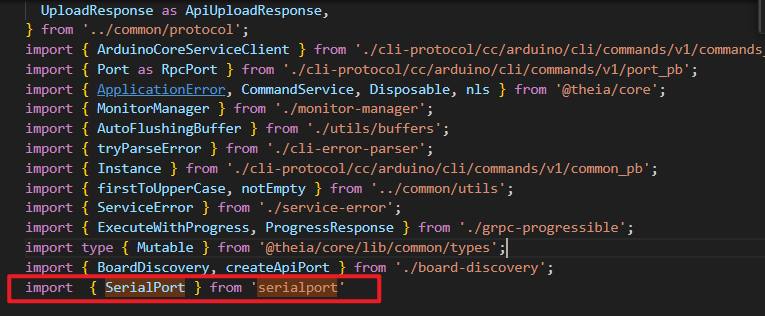

The packaged exe failed to start
I added the dependency and used it, it worked fine in the test environment, but the packaged exe file didn't open, what went wrong?

Windows, I have used the official version, but there is no ISP one-click download function, each burn needs to press the reset button, so I want to use the software to reset before each download

Error: No native build was found for platform=win32 arch=x64 runtime=electron abi=118 uv=1 libc=glibc node=18.17.1 electron=27.0.3 webpack=true
    loaded from: D:\software\Arduino2.3.3\Arduino IDE\resources\app\lib
    at g.resolve.g.path (D:\software\Arduino2.3.3\Arduino IDE\resources\app\lib\backend\main.js:2:3279093)
    at g (D:\software\Arduino2.3.3\Arduino IDE\resources\app\lib\backend\main.js:2:3277146)
    at 73215 (D:\software\Arduino2.3.3\Arduino IDE\resources\app\lib\backend\main.js:2:986367)
    at __webpack_require__ (D:\software\Arduino2.3.3\Arduino IDE\resources\app\lib\backend\main.js:2:6416470)
    at 98786 (D:\software\Arduino2.3.3\Arduino IDE\resources\app\lib\backend\main.js:2:977705)
    at 71782 (D:\software\Arduino2.3.3\Arduino IDE\resources\app\lib\backend\main.js:2:981297)
    at 86652 (D:\software\Arduino2.3.3\Arduino IDE\resources\app\lib\backend\main.js:2:3489981)
Node.js v18.17.1
It's too long. That's the point
Putting the serialport library's prebuilds folder in the electron-app/lib directory will work, but I don't know why
Could you tell me how to do it, or is there any relevant documentation, thank you very much
