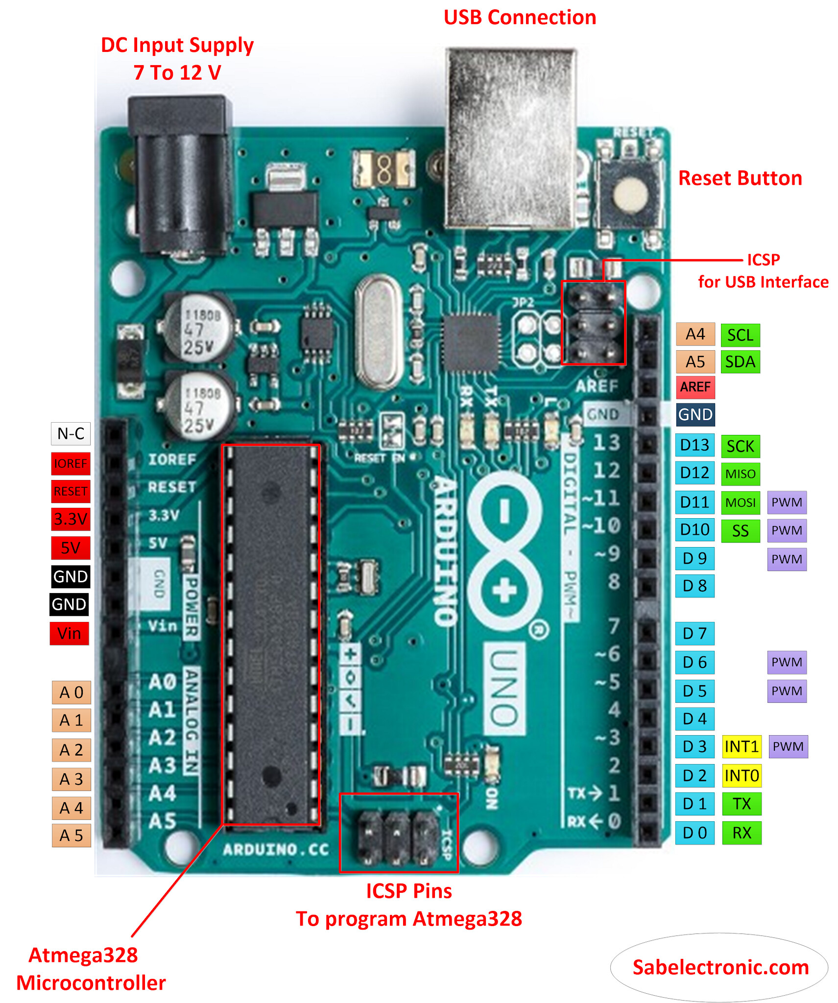

A4 and A5 are used for I2C on an Uno.
Try using A0, or A1, or A2, or A3.
A5 is the SCL pin
Could this explain your problem ?
Thanks man
but can you explain it more for me because I am new to arduino and I have been trying to solve this problem for hours!
I changed it from A5 to A0 and it worked.
but actually I did not understand what was the problem of using A5 and SCL, SDA together.
Since SCL, SDA and A5 are three different pins.
A5 and SCL may be differently labelled pins on the Arduino board but they are both connected to the same pin on the actual processor
Pins A4 and A5 serve 2 different purposes but can only be used at a time for one purpose. I2C or Analog in.
