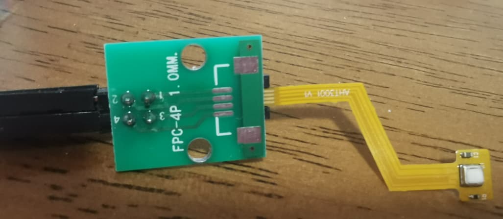

The temperature and humidity sensor's information can be found at AHT3001 Temperature and Humidity Sensor
My circuit details:
The pullup resistor for SDA & SCL is 4.7kΩ(I also tried 10 kΩ).
The RC for VCC is 106 and 100 Ω.
The code for scanning:
Wire.begin();
Wire.setClock(100000);
Serial.println("\nI2C Scanner");

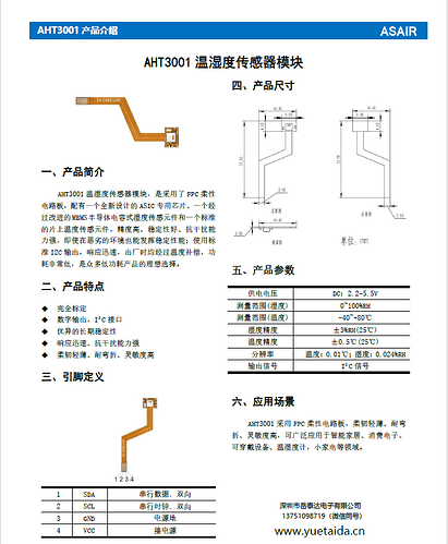

I see no link to the appropriate data sheet.
Hi robtillaart,
Very appreciate your quick reply.

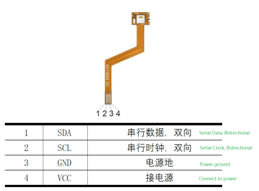

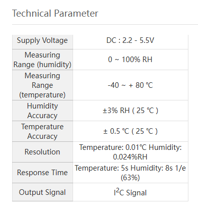

Actually, I didn't find a datasheet in English and the picture below is the pin definitions missing.
And its technical parameter is like below
My circuit diagram is like
I have tried different R1 values like 10Ω,100Ω, 330Ω with VCC 3.3V and 5 V and no one works.
VCC 5V + R1 10Ω, the scanning will be stuck
VCC 5V + R1 100Ω, normally, the scanning won't find the sensor. Occasionally, it will get stuck or tell me the sensor found at 0x01(I think this is wrong).
VCC 5V + R1 330Ω, the scanning won't find the sensor.
Besides, this is its official website: http://www.aosong.com/en/products-114.html
Any language is OK,

I just snapshot it. It is an only 1 page file.
Besides, 3.3V with 1K also cannot be recognized.
Thanks, it provides no new information (google translate: Chinese => English)
On the website you linked to in post #1 , is an email address.
Maybe you should contact them for a more detailed datasheet which includes registers to access for temp / humidity etc.

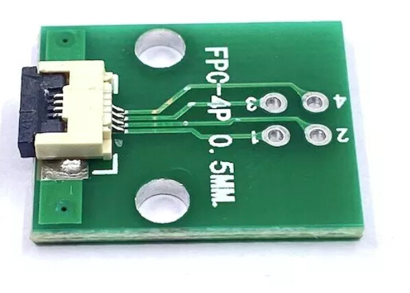

You may have it wired backwards.
Pin 1 of the AHT3001 is on the top in your picture. That may be connected to pin 4 on the header
moteinX
October 20, 2024, 10:41am
17

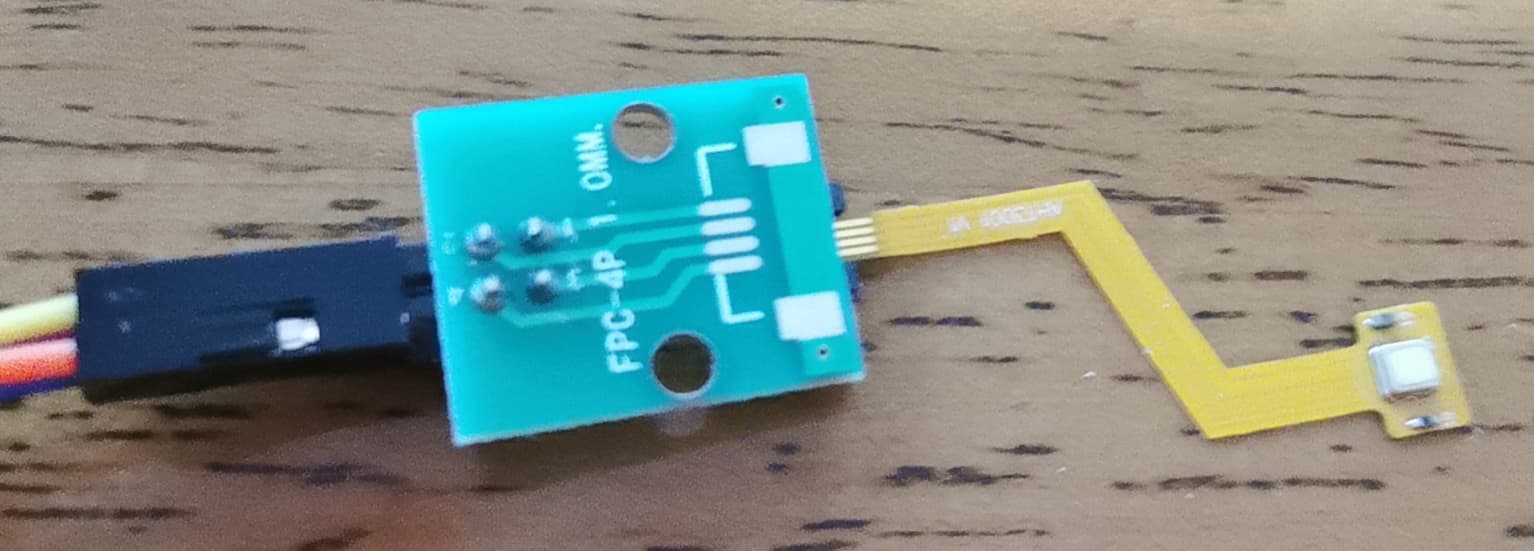

Hi jim-p,
I think you mean I should wire it like this way, right?
I just tried it with 4.7Ω pull-ups, and it is still not recognized.

No, the FPC cable orientation in you first picture is correct.
If your board looks like the one I show, then it's the connections on the pin header that need to be reversed.
See how pin 1 of the FPC connects to pin 4 on the header.

I just changed it back and exchanged pin 1 and pin 4 as above. Then scanning program get stuck.
jim-p
October 20, 2024, 11:23am
20
It may have been damaged when you connected it wrong.
