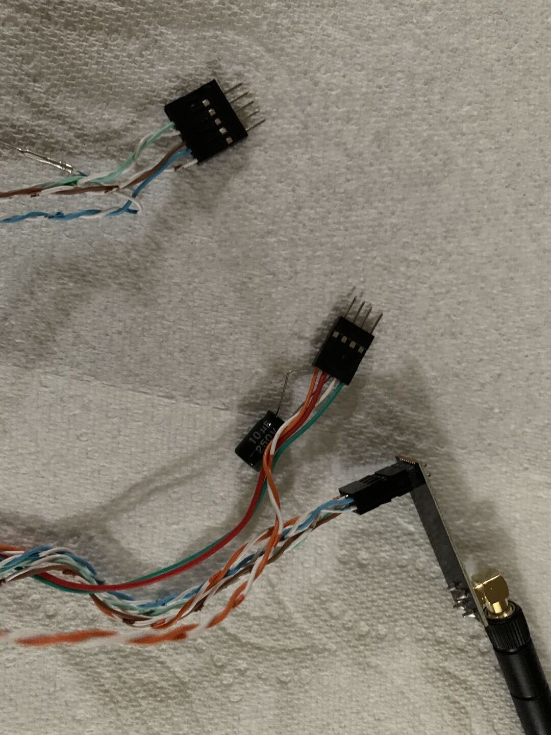

Here is my "usual suspects" for getting the rf24 radios to work.
If you read and, closely follow Robin2's simple rf24 tutorial you should be able to get them working. That tutorial sure helped me. Run the CheckConnection.ino (look in reply #30) to verify the physical wiring between the radio module and its processor (Arduino).
Make sure the rf24 power supply can provide enough current. This is especially true for the high power (external antenna) modules. I use homemade adapters like these. They are powered by 5V and have a 3.3V regulator on the board. Robin2 also has suggested trying with a 2 AA cell battery pack.
If using the high powered radios make sure to separate them by a few meters. They may not work too close together. Try the lower power settings.
Reset the radios by cycling power to them after uploading new code. I have found that to help. They do not reset with the Arduino.
Switch to 1MB data rate to catch the not so cloned clones. radio.setDataRate( RF24_1MBPS )

Posting a schematic, not a frizzy thing showing how it is wired would help. Also note the modifications you made.
I wired a rf24 up to my Mega using your code as a guide. The rf24 is powered by a homemade adapter as described in my prior post. I uploaded your code, unchanged. The receiver is an Uno with a similarly powered rf24. Both receive and send functions are working well. So it is not the code. That points to a hardware problem (usually power).
Copy and paste the results of the CheckConnection.ino sketch for the sender and receiver into a new post.
Thank you groundFungus.
I made the picture shown connector before my order homemade adapter arrived, and guess it works, I have made NRF24L01 Transceiver by the first two sketches only from:
and also I checked connection both sides fine.
maybe yes, the power, I used two AA which measured 3.21V?
