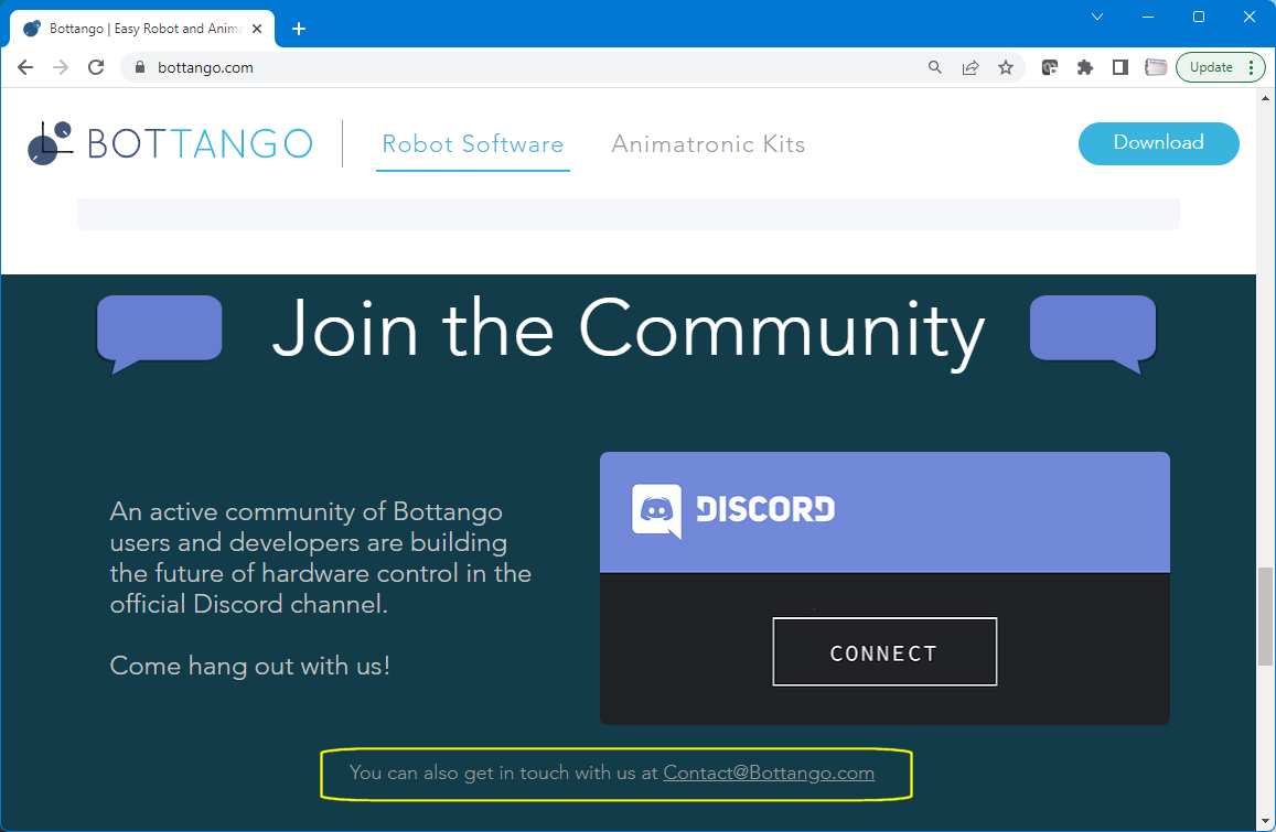

I use software called "bottango"
in documentation said. each servo need their own PWM pin.
max is 6
so I need 2 controller.
I'm not familiar with it.
Any reason you are not using the Arduino IDE?
