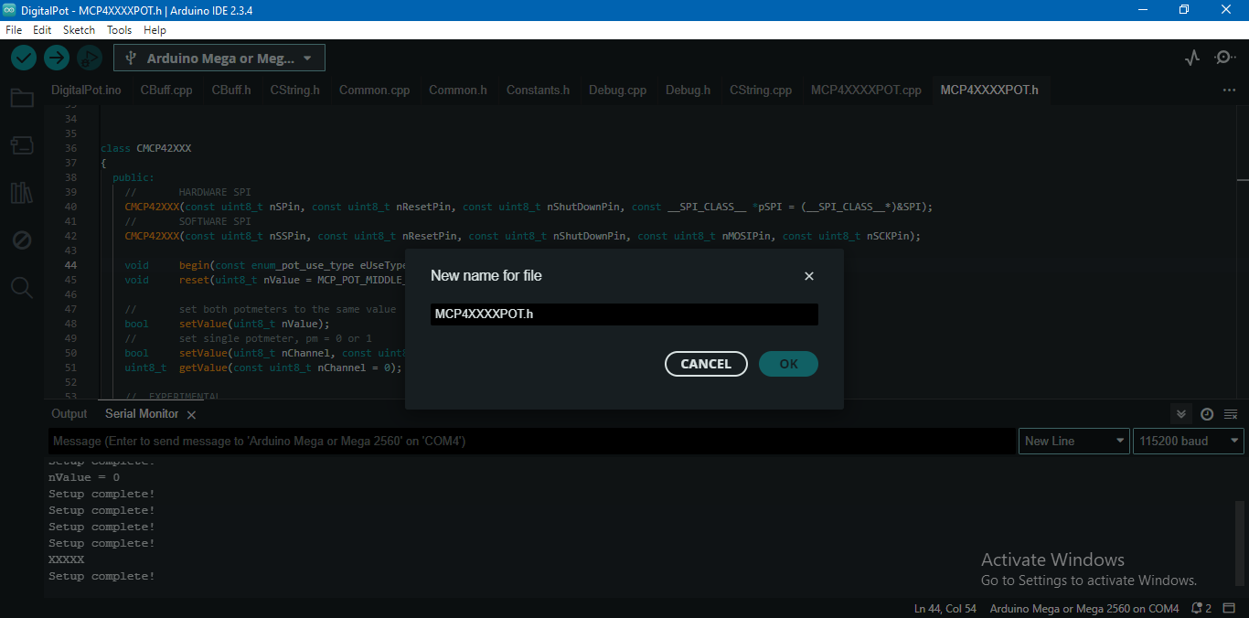

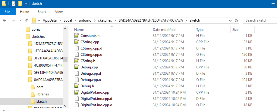

There is also another REALLY IRRITATING bug in current IDE version.
If you rename a file...
Then the source, .d and .o files belonging to the previous names are not deleted from the temporary folder...
And you get compile errors such as missing header files when you try and compile again. And there is no visible cause of those errors back in the IDE.
One has to browse to the temporary folder and manually delete the offending files.
You need to have a checkbox or menu option for 'rebuild all' like visual studio has. Where upon the IDE deletes all the temporary all the files from the temporary folder and rebuilds from scratch.
It would confuse the hell out of beginners who don't know about object files and such like.
Well this bug is another possibility as a cause my I2C problems I suppose.

The problem you described is only that the previous source file is left behind in the build folder when you rename a secondary sketch file. It doesn't have anything to do with the core and library cache.
So I don't see any reason to believe that the same bug would have any effect on the Wire library. It is possible there is another bug. If you are able to reproduce the problem with the Wire library, please provide instructions we can follow to replicate it on our own computer. That will allow us to investigate further.
Instead of increasing the complexity of the Arduino IDE user interface, and putting the burden of cleaning the temporary folder on the user as a workaround for a bug, don't you think it would be better to just fix the bug?
