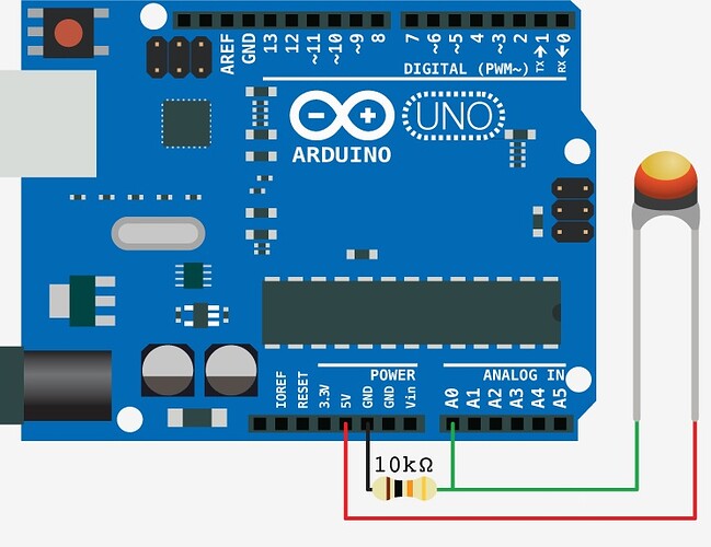

I am trying to output the temperature from 2 thermistors with smoothing. I am using an arduino uno with a 10K thermistor (SEMITEC 103AT) with a 10k resistor. I have 2 problems with my code right now
  1. When connected to 5V as reference I am getting 23.5C (room is probably 21C) connected to 3.3V I get 6C I don't know how this is possible.
  2. If I have a thermistor only connected to A0 the serial output associated with the pin A1 will change as well although it will be a lower number. I have tried adding serial outputs to try to understand where my problem is but I'm stumped.

What are you connecting to 3.3V?
The thermistor and resistor act as a variable voltage divider, so if you supply it with 3.3V instead of 5V, I would expect it to read low.
Are you also switching the Arduino to 3.3V? Using Vcc as a reference voltage, or the internal reference?
I'm powering the Arduino by USB and I was trying to reduce noise by connecting the reference voltage of the thermistor voltage divider circuit to the 3.3V pin rather than 5V. So ya it does make sense that the voltage would change as proportionally to the reference voltage.

You set the reference to external, then connect Aref to 3.3V.

That formula works only if both the thermistor circuit and Aref are running from the same voltage.
Don't forget to add a bypass capacitor to Aref and AVcc. Something like 0.1uF and 47uF.
Do NOT try to connect AVcc to 3.3V. It must run from whatever Vcc for the AVR is.
From the datasheet:
"The ADC has a separate analog supply voltage pin, AVCC. AVCC must not differ more than ±0.3V from VCC."
"The ADC converts an analog input voltage to a 10-bit digital value through successive approximation. The minimum value represents GND and the maximum value represents the voltage on the AREF pin minus 1 LSB.
Optionally, AVCC or an internal 1.1V reference voltage may be connected to the AREF pin by writing to the REFSn bits in the ADMUX Register. The internal voltage reference may thus be decoupled by an external capacitor at the AREF pin to improve noise immunity."
See Figure 24-1. The reference voltage may be Avcc or 1.1V, or the voltage on the Aref pin.
If the Aref pin is not being driven externally, then whichever is selected of Avcc or 1.1V will be present on the Aref pin, hence the suggestion to have a 0.1uF cap on the pin for improved noise immunity.
The analog reading thus represents your voltage divider reading with 1 bit = Aref/1023
With Avcc = 5V, 1 bit = 5/1023 = ~4.887mV
With internal 1.1V, 1 bit = 1.1/1023 = ~1.075mV
With Aref driven externally, 1 bit = Aref/1023.
Here you can see how the ADC reference voltage gets selected, and why it appears on the Aref pin - and why the Aref pin should not be connected to 5V; only a cap to Gnd should be connected.
When using an external reference on Aref, such as the 3.3V available on the Arduino, I think I'd use something like a 1k resistor between 3.3V and Aref, with the 0.1uF (and possibly a 47uF cap) from Aref to ground.
In that way, when the Arduino first powers up and the code has not set Aref to External, you won't be cross connecting Vcc of 5V with 3.3V via Aref.
