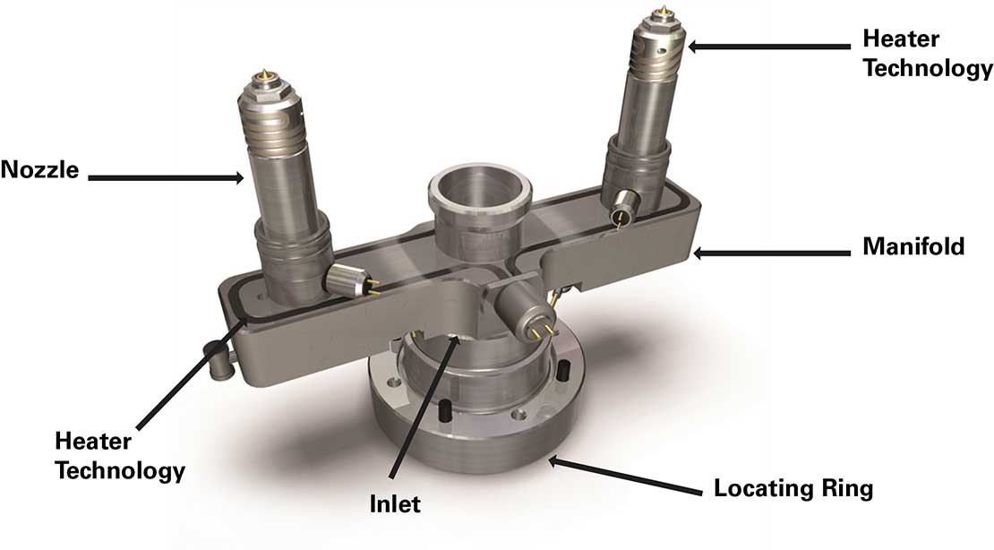

I can't get into most of the molds right now because they are in use. However this is these are the kinds of heaters in use. The sprews and manifolds just have raw thermocouple in them like this.
Most of the thermocouple are grounded, but I haven't checked to see if all of them are. I can make the 31856 chip work with a grounded TC as long as the DC side of the card is floating compared to ground. Am I correct that the lack of ground reference makes the shielding ineffective though?
